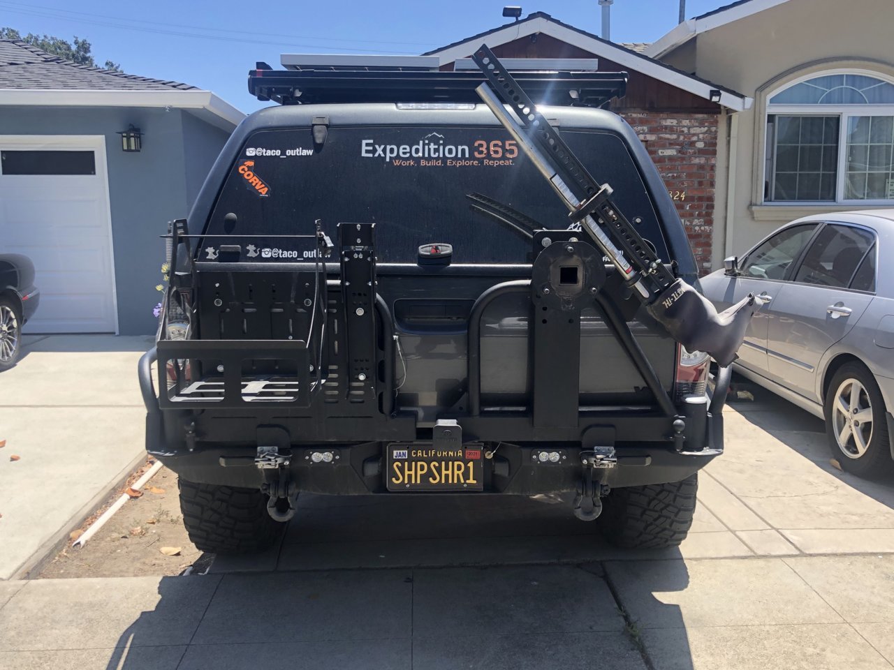

    Alex @sytfu510 used to have a similar setup as yours. You should hit him up bro.

    good call. I know he just removed his setup.

    Let’s see how it feels with 150lbs or so off the back.

    Sick truck bro. Looks like you’ve put a lot of work into it.
