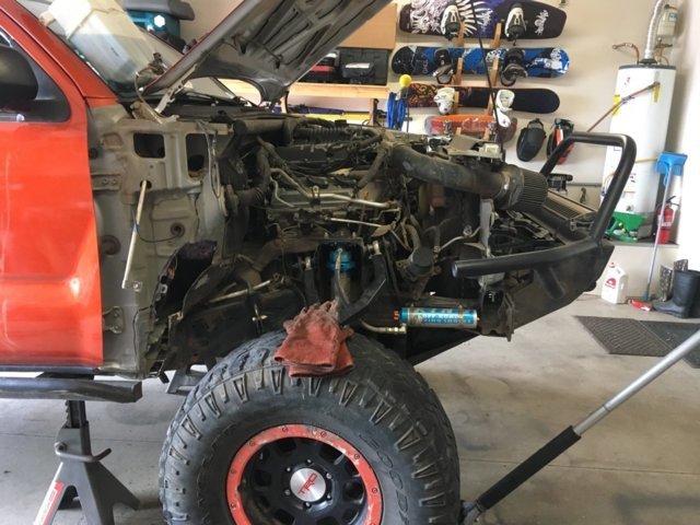

    Inner might be based off a 930, but their site says the outer is Dana 60. Either way the 930 is still beefy.
    I still have “stock” tie rods (extended for the long travel). And that gain was over my already modified dirt king inner cv’s which are machined to give more travel anyways. Now I am maxing out the kit at the uniballs and getting as much travel as a 2wd which is awesome.

    No inner fenders and that big hole to start the clearing 37’s with long travel. The hole ended up much larger than that.

    just be prepared to cut and tub the shit out of the front end. To fully stuff 35's you need to do a bunch of that anyway. maybe not with the body lift but once you get there lots of cutting and welding @snowsk8air2 post shows his. There is a good thread on fitting 35's and 37's that covers it.

    Are you guys all watching the JD fabrication threads? They have a new system where you cut all your lower mounts off And weld in a whole new reinforced sub frame. It moves your lower control arms up to an inch forward so you don’t need to cut as much crap out of the way. Just welded my kit on this weekend

    The installs pretty easy, but the cutting and grinding is a lot of work. The installation instructions are really only provided through the forum, but it’s pretty self-explanatory. It uses the factory skid plate points To mount up to help you align for welding. It comes with a new skid plate steel or aluminum in the front bar is removable so you can use it as a pick up point for a custom bumper or bash plate. There’s a ton of value in it when you compare it to lower control arm reinforcements, skid plate, bumper mounting, not having to cut as much crap out and get really solid alignment numbers
    edit It also comes with crazy beefed up mounting hardware and cam brackets so you can actually lock your alignment in to place
