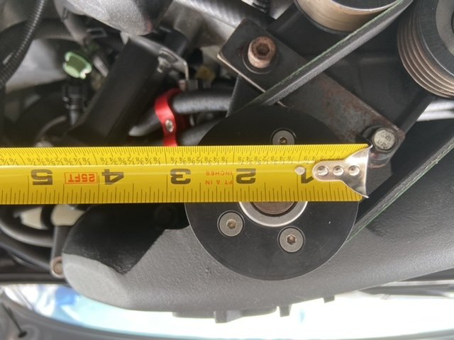

    Ok that makes sense. Is the tensioner towards the bottom of the engine? I would like to check so see if I have an upgraded pulley. I also just measured it and it is 2.75. Would that mean it is a 2.7?99FECEE1-F7B2-4DFD-941E-9E28E9AB17C8.jpg(Sorry it is upside down. I don’t know how to change it on my phone)

    That's not a 2.7. Pulley sizes are based upon the internal rib diameter. Not the outside diameter of a pulley. It's a 2.5.

    Looks like the user had a wrap mod on there at one point too. any chance you know the previous owner? They def played in this thread plenty. Also 2.5 vs 2.8 not a bad to try it out. May not be a big MPG difference. If we know whos truck it is we would know the history most likely.
    If you do decide to go from the 2.5 to the 2.8 you should have it tuned again but the nice is you can assume you probably hav an upgrade fuel pump. if its an auto maybe you have valve body job.

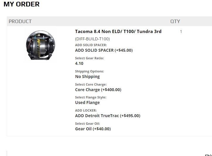

    I ordered a front 4.10 carrier from eBay. Had trouble finding a decent deal on a rear one and just now did a thing.
    SUMOTNK and BassAckwards like this.
  18. Jun 19, 2020 at 4:18 PM
    JuanitoBonito
    JuanitoBonito Que Pasa
    Dec 29, 2013
    #119422
    9,194
    Juan
    CHI-TOWN
    2024 Raptor
    Nice, but @snowsk8air2 found that ecgs does sell 4.30 fronts and rear So you may want to return those.

    Page 1 will have all the info but like @12TRDTacoma said if you have the rousch then no need. You can see the bar running across under your pulley. Looks like it was there (ie: wrap adds another pulley)

    I want 4.10 because it puts gearing on 33" tires just about even with gearing on the stock 265/65/17 tires.
