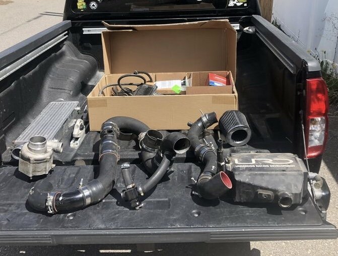

    Can anyone confirm if this is a URD supercharger for the 4L? Bonus points if you can figure out the stage number or spot any missing parts
    Its the only picture I have so far ( crappy i know) and would like some reassurance before I offer to put a deposit on it. Unfortunately its about 750 miles away so I cant just go look at it myself and the seller is apparently away At their shift work until first week of July so I cant get more pictures until then.
    its listed for $1500us.
    Thanks!

    I’ve never seen the URD kit in person. If you can’t find the info here on the forum, maybe try calling Steve (Gadget) at URD and see if he can identify what’s in the pic.

    Looks like a mk1. Stage is dependent on pulley size and (if I remember right) has a 7th injector.

    Does that include the UCON? You will need that or similar engine managemeent to run it.

    na its super old. so like map ecu 2 or 3.

    I only see the bypass valve. Not a port for the HKS BOV.
    The intercooler looks too small, and the thing on the right of the tailgate looks like the water to air intercooler.
    So it does look to be for the 1GR. However all signs point to URD's first iteration of chargers. Not the more efficient current ones.
    If ever buying a rotrex, or whatever, have the buyer send video of them spinning the charger and looking at the impellers.
    A guy once got a kit. Maybe it was on buying a used truck. Was diagnosing why it made no boost. Come to find out, there was no impeller. Lol.
