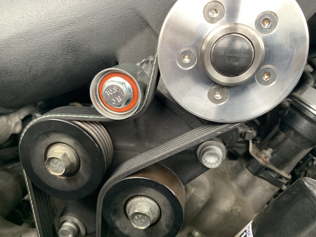

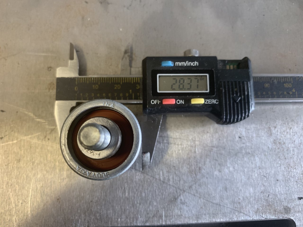

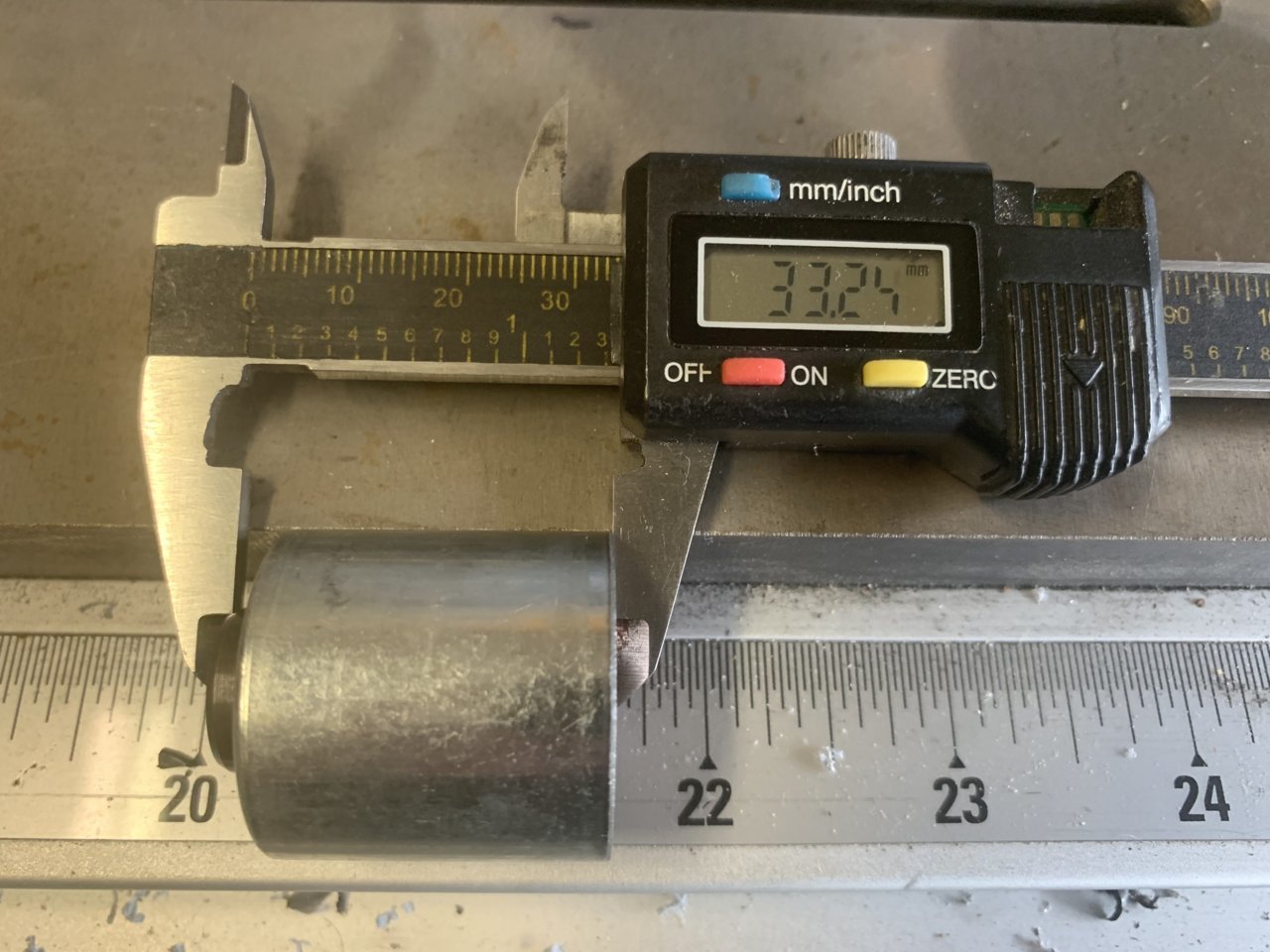

    There is another VW TDI idler pulley that’s smaller. It’s approximately 28mm diameter and 28mm depth with overall length of 33mm. It will sit the belt right in the middle of the pulley with no grinding. All you would need is a longer bolt.
    Would provide slightly less pulley wrap than the one @BillDaCat8 is using. I haven’t tried it though. Might wear quicker due to it spinning faster or the bearings may be smaller. It might blow your truck up or something so use your best judgment here.

    Oh hey, look at that. Looks very similar to the bigger one I went with.
    I agree about the smaller diameter and the speeds it’d be running at. I have my concerns about the larger one that I’m running as it is. So far it’s been fine though. Had it off a few weeks ago when I put the fancy spark plugs in and it still felt fine.

    I decided to throw it on for the hell of it, just to see how it fits. With the 2.7 pulley, Roush tensioner and stock length belt, I don’t think it’s necessary at all for my combination of parts. I took a pic for y’all before taking it back off.

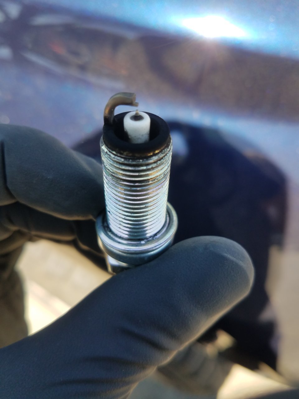

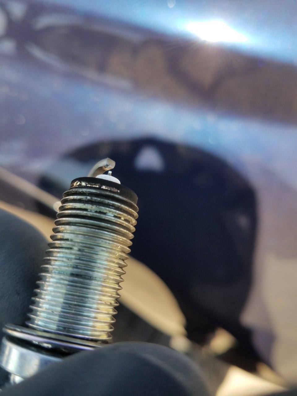

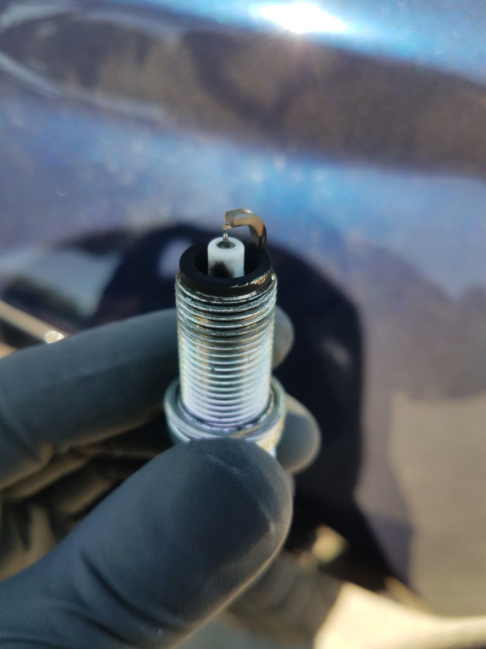

    1500 miles on the Rutheniums.. they look considerably cleaner than my Iridiums ever did.

    Let’s see how these rutheniums look at 30k before ranting and raving :cool:

    I don't count on 30K, but there was no ranting and raving, only stating the facts of my findings which at this moment appear favorable over the latter. :thumbsup:
