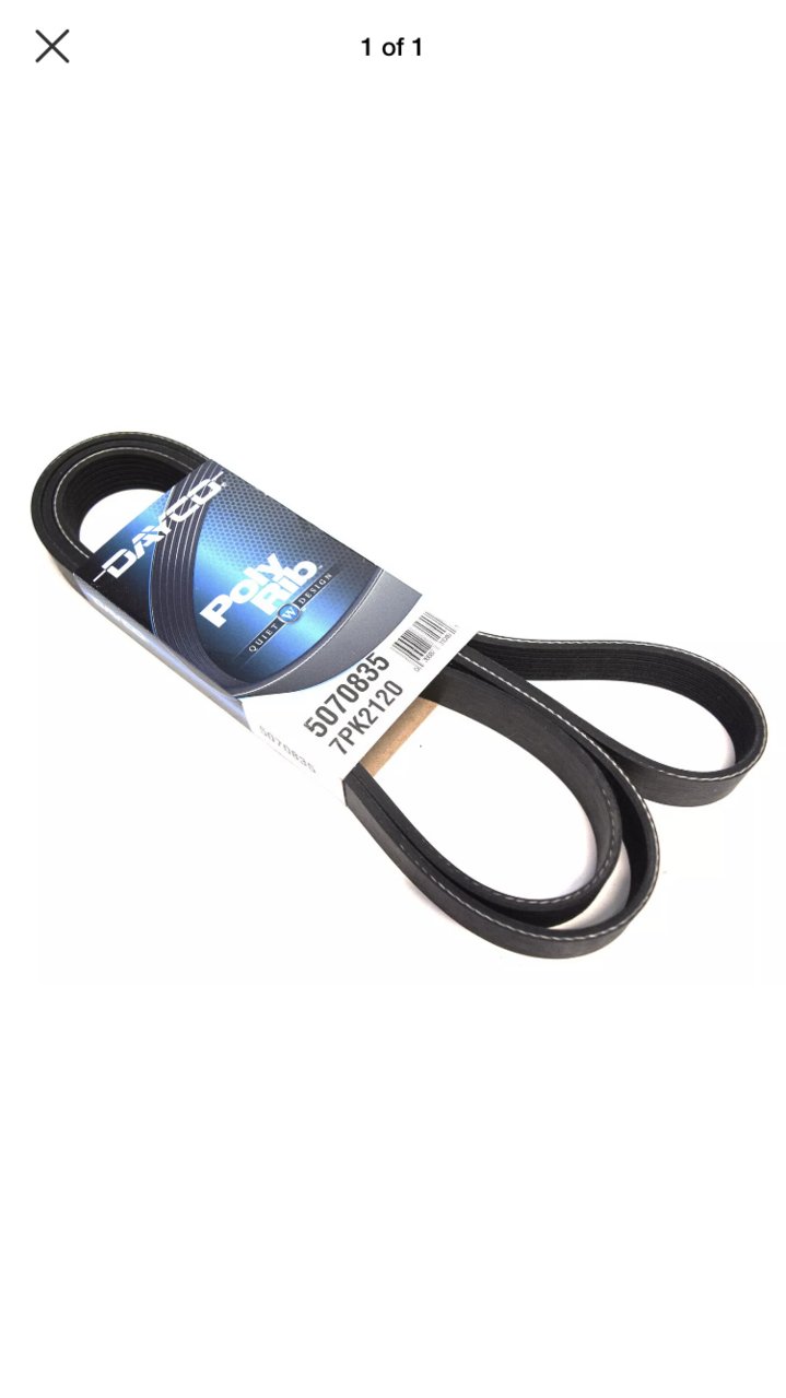

    It’s the main belt that is squealing. Not the sc belt.
    I’m not running the aircon.
    Using a dayco belt that is standard for this engine. Not sure if the model number but I can find out.
    Standard pulleys for everything. Haven’t changed any. Only pulley I have changed in the sc pulley but that belt is fine.

    Take the spray bottle like @zippsub9 mentioned, and squirt the belt as it's running from the side of the of the engine compartment, by where the AC compressor is. If the noise goes away then it is belt related, not bearing related. I have a feeling that your accessory drive belt is the issue because Dayco belts have a track record of being built of inferior materials.
    Also as a footnote, the OE accessory drive belt is made by Bando, not Dayco. The Supercharger belt is the one made by Dayco.

    Not here they aren’t. The main beltnis also a dayco. Brand new belt. I was thinking of going a gates belt as have heard they are better.

    Interesting. They must hold a different contract for the belt manufacturer of OEM in different regions of the world. Out here in North America it is a Bando.
    Switch to Gates for sure. A standard Century series should do the trick just fine. Before you do that though use the spray bottle. I'm almost confident it's the Dayco belt which is your issue, but this will just solidify those thoughts.
    I believe the part number should be K070835 for Gates.
    If you are feeling adventurous run an RPM series belt, I would not run a Fleetrunner, however, as I have experienced heartache with those for some reason (at least on the accessory drive belt side of things) it is possible I got a very old belt because it started cracking quickly, but who knows.
