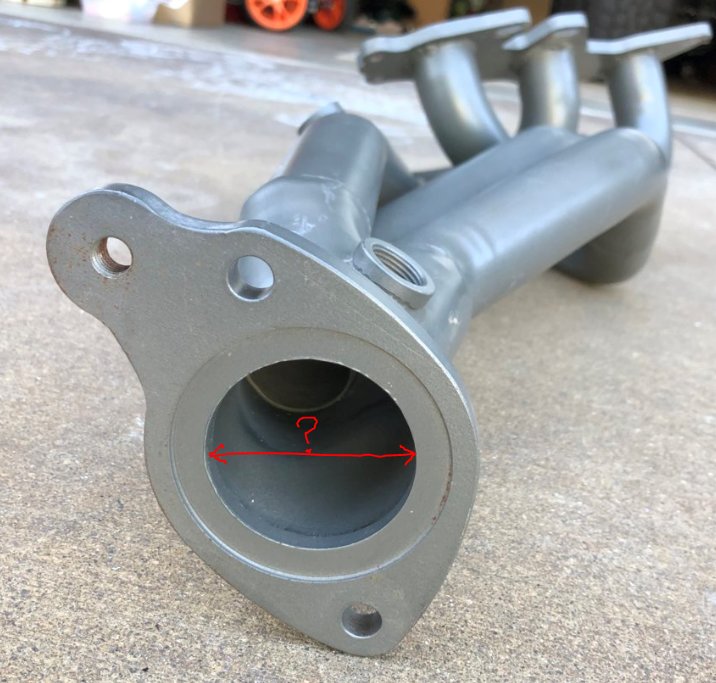

    Does anyone know the collector tubing diameter of the Ü R D long-tube headers?
