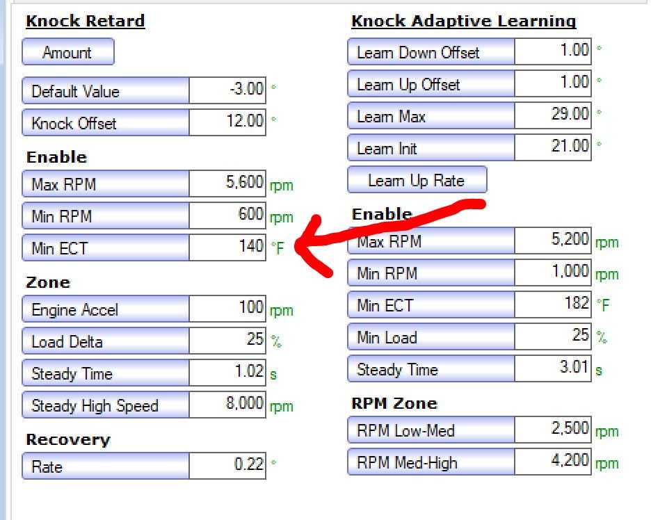

    There are multiple places in the 1GR tune where ECT is referenced, namely in the timing area. There are at least 5 tables and a few other fields. These are just the ones we can see with HPT. I wouldn't be surprised to learn that there are more that we can't see.

    Generally speaking, no, there is nothing that will limit power in our ECU's due to cold ECT's, however one thing to keep in mind that knock control isn't active until ECT are 140deg F. So should something happen (bad fuel, or anything else really) before you reach that threshold. You literally have nothing protecting your engine. Something to keep in mind.

    This is AWESOME info! Noted. I will keep it down until I hit 140 from here on out.

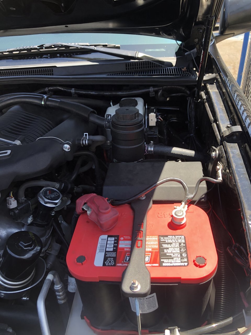

    Not sure if this is the right area for this, but here is my question. I am looking to add auxiliary power to my truck, and really like the setup from Overland Equipped. My problem is that my intercooler reservoir for my supercharger Sits right where the auxiliary power goes. Has anyone ran into this problem? If so, what was the work around? I was thinking I could re-locate the reservoir, but not sure how big of a pain in the ass that would be. Any suggestions?

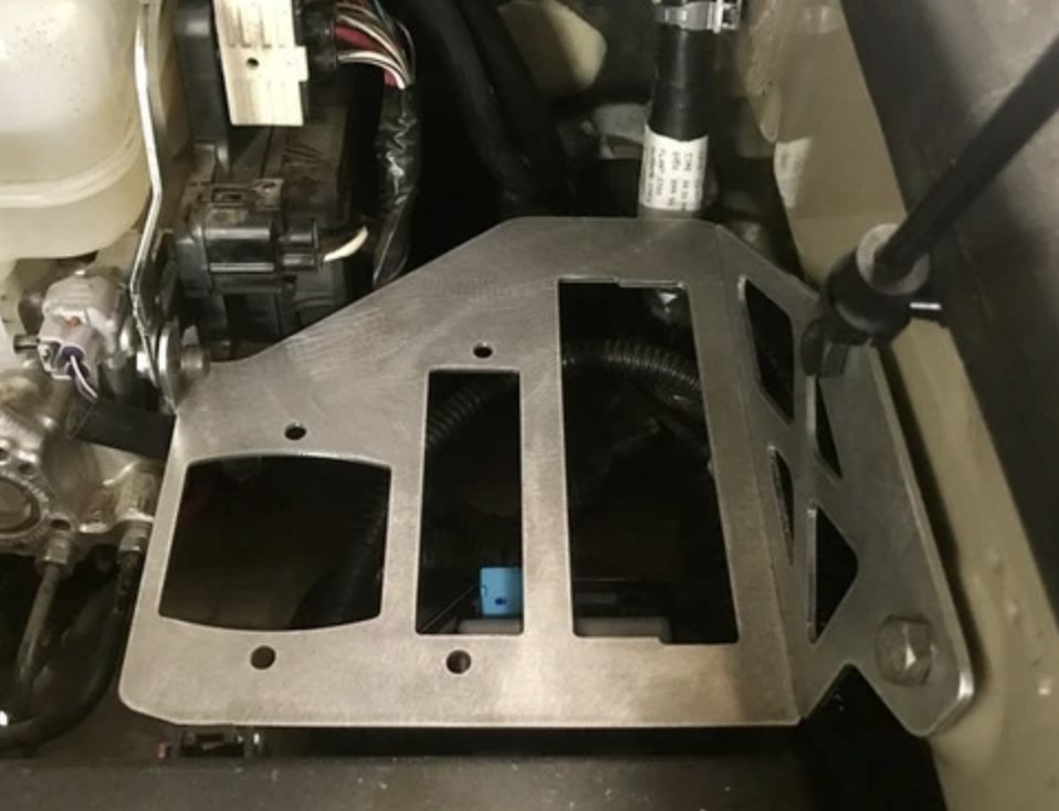

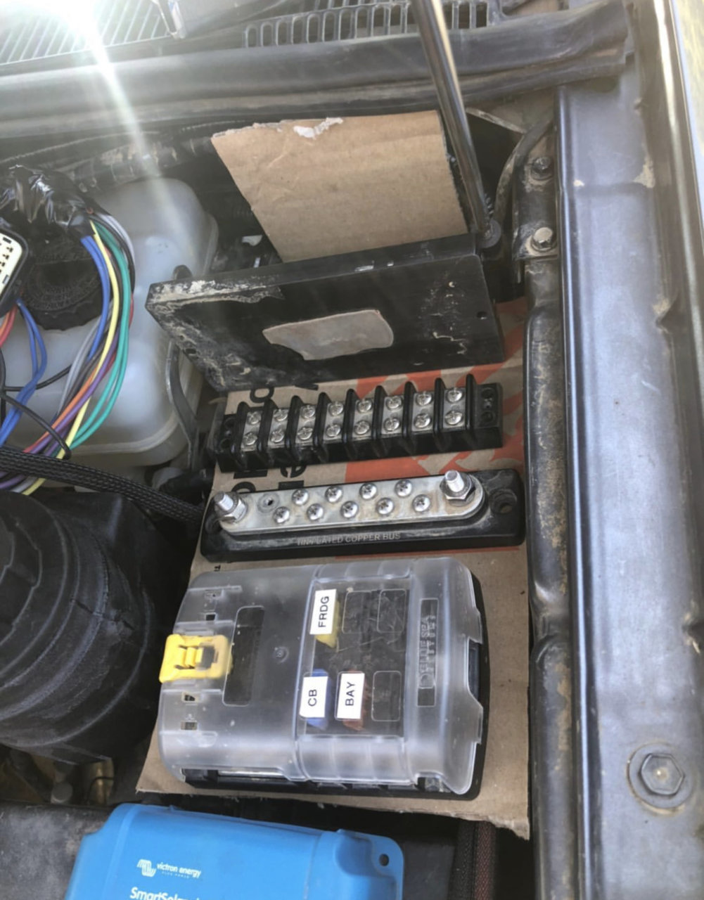

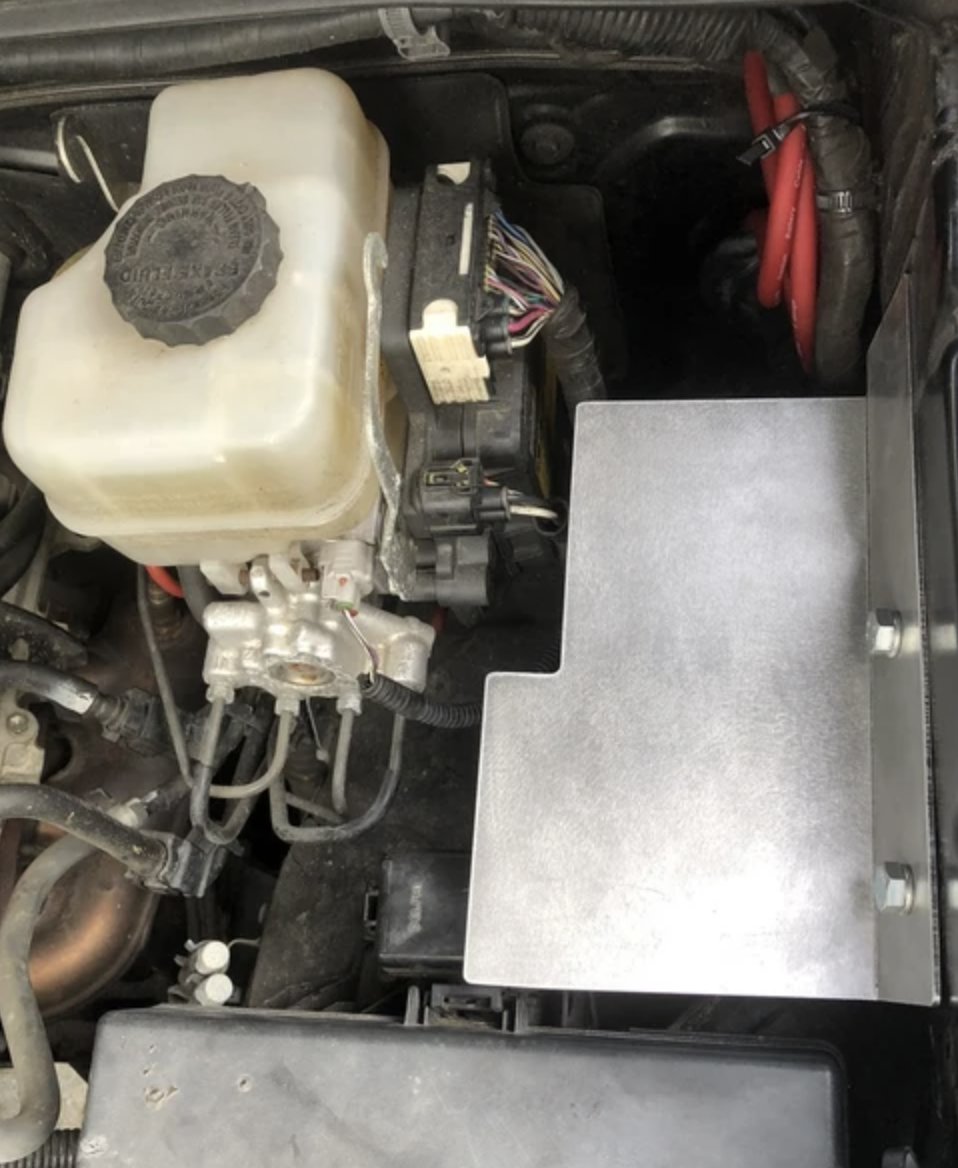

    Pretty much everyone who had one there. You have a couple options. Some people ran the resi to the passenger side. I thought about doing this but ended up putting a dual battery setup there. Depending what you plan to mount there are a couple "shorter" plates for mounting fuse panels and such. I am talking with a guy at Paranoid Fab in San Diego about making a custom one that will mount my switch pro, blue sea fuse block and a couple distribution blocks. I plan to go length wise instead of towards the engine working around to accomodate the resi. I mentioned that if he can pull it of there may be a few other S/C guys that would be interested.
    here are 2nd and 3rd gen ones he makes. instead of the wider versions that other companies make.
    This is the 2nd Gen off the shelf with ATRAK he makes
    this is the 3rd gen one he makes (MESOjdm designed it but he made it) I like this design as it bolts up to the same point that resi bolts into. I mocked up a design with cardboard and should work if he can bend and cut to my dimentins with the switch pro at one end for an option.
    this is a cardboard mockup. It’s higher due to the coolant lines below and the switch pro would be another inch lower to accommodate the hood etc.

    yah the switch pro really would be on the end so would not be that much different. you may be able to use his standard ATRAK version for 2nd gen. Just ping him and tel him you need some holes. It wuld fit a 6 fuse bluesea and breaker easily maybe more. Or get similar to what im talking about which would be wider but shorter than the one you posted.
