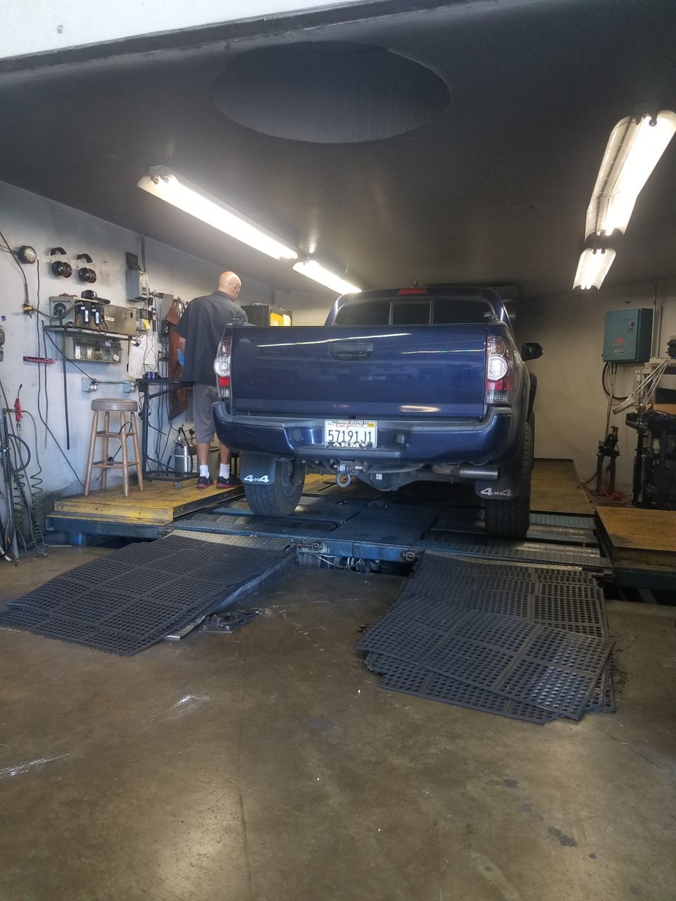

    It's going down now!

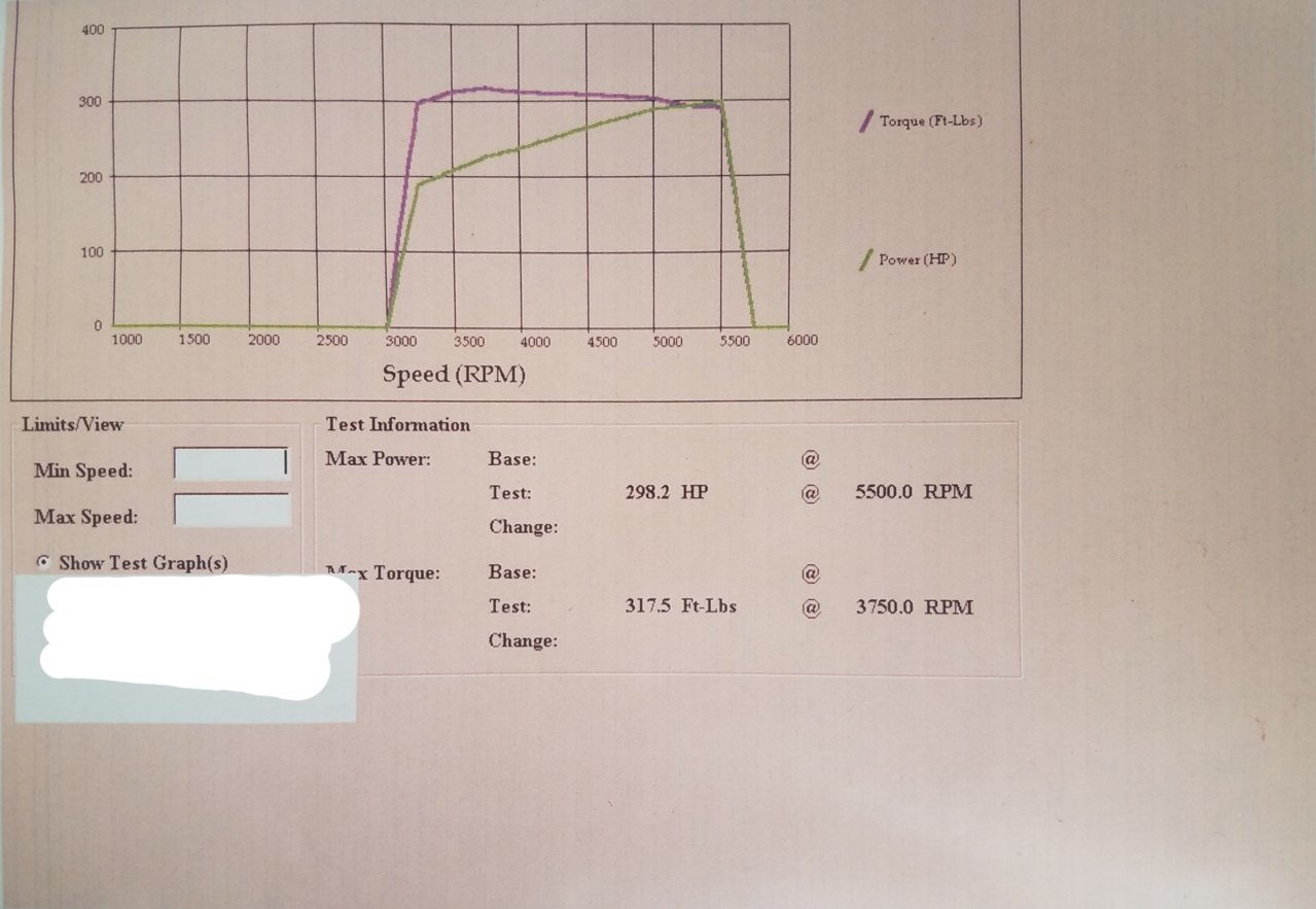

    Disappointing.
    298 wheel HP. Factor in 18% drivetrain loss and I'm at 351 crank HP on a Mustang loaded Dyno.

    It’s all about power to weight though

    Well that is true. This thing weighs some 4600lbs as stands. I also have all 4 cats and a still OE style modified Y pipe in play so there are those factors.

    How hot out was it?
    My MAF values were really disappointing after installing the URD headers and Catless y-Pipe with the S2 flash of the UCON. But it was 90 and humid AF.

    What I've bolded above & stock manifolds.. This is what is holding you back.

    82* today.
    Are the OE manifolds really that hindering in flow? I can mod the rearmost post cats but at the time of this writing the OE cats must stay in play.

    Results... I feel like it had more in it. I saw one of the traction lights flashing so I get the feeling he didn't fully disengage it prior to the pulls.
