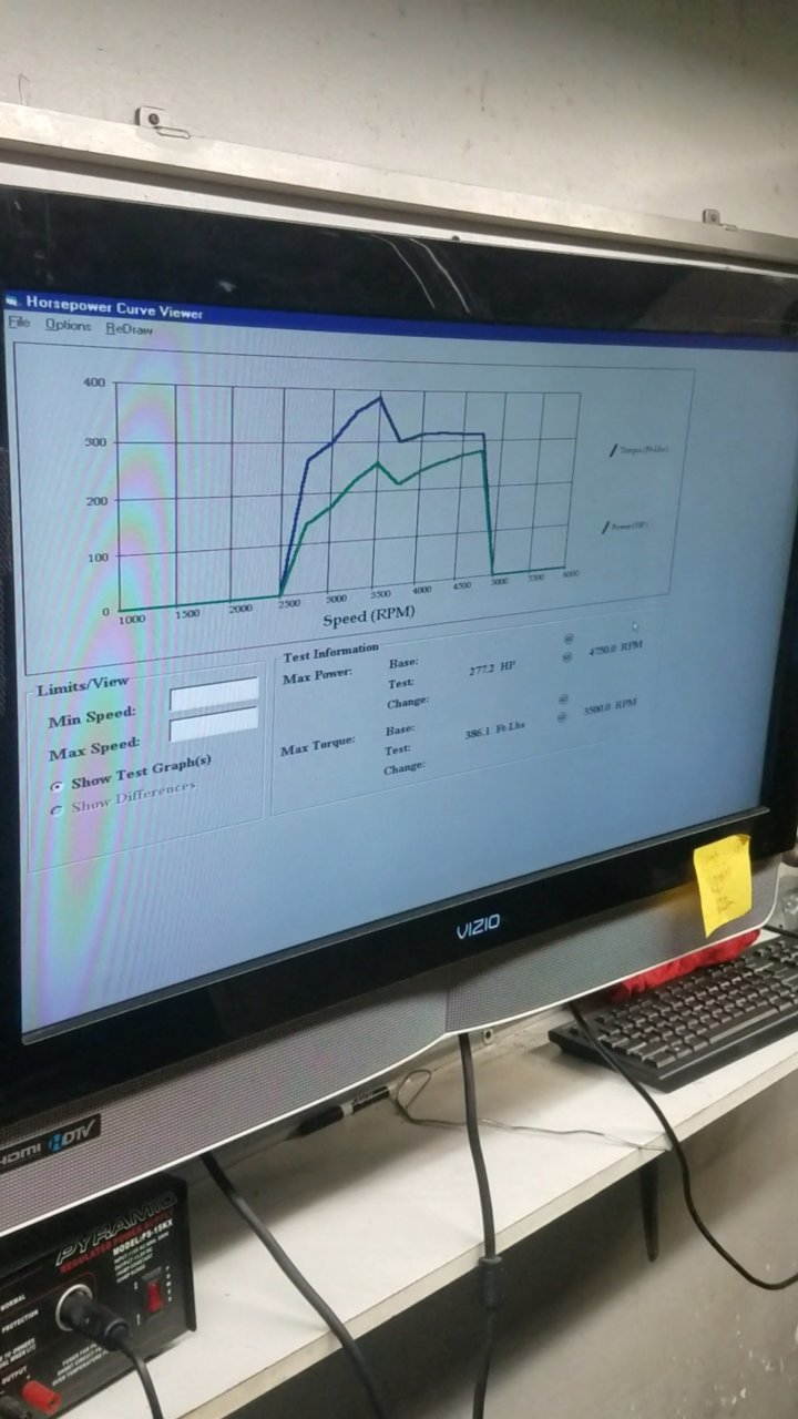

    When I got tested in 4th, it showed 277 HP/ 386 TQ at 3500 RPM. So it netted a considerable HP loss but a fat TQ increase.

    Did they go full rpm in 4th? The HP should still be higher at a higher rpm than 3500.

    No I mean TQ at 3500 was at its peak but at full RPM of 5500 he got a final result of 277 HP. Hang on I'll throw the screenshot of the result up.

    That looks like traction control.. Ie: throttle closure. You can see that the truck was on par for WAY more power than you actually made. The datalogs would have helped tell what's going on for sure, as I can only speculate at this point.

    Good to know. I put in the call and asked for the owner. He is supposed to give me a call back once he is done on the dyno and will let him know the situation. If he grants me access to some dyno time again I will make sure I run a datalog prior to the pulls and have the guy re- running the test absolutely kill all the traction. Hell I will probably just pull all the fuses to make sure we are clean.

    When I did my 340hp/370tq dyno pulls, it was done in 4th gear but I ran into the speed limiter.
    Raise your top speed governor not your rev limiter. Dyno in 4th. Disable all traction control stuff. Make a 4th gear dyno pull all the way to 5.2k-5.5k rpms.
