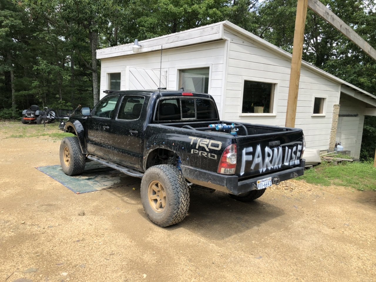

    How are you supposed to haul hay around with those massive coilovers taking up half the bed?
  9. Jul 17, 2020 at 9:37 AM
    3pooches
    3pooches Well-Known Member
    Jul 6, 2017
    #223346
    5,487
    VA & WV
    15 tacoma dcsb Sc Linked, 2014 reg cab locked
    I have a hay truck for that. This one hauls goats and sheep, and they require a plush ride.

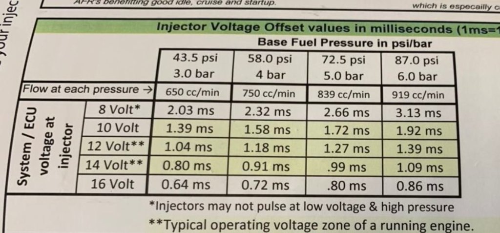

    Injectors are 630cc. Do you think it’s better to streamline with hpt and remove the 7th injector? Which setup gives you better drivability in your experience?

    You’ll need a bit more info than just the cc/min of the injectors. Most manufacturers have a data sheet for the specific part number.
    Voltage offset is one of the important parts to have. And then if I remember right, minimum pulse width. Then you have some math to do as well in order to get in the ball park. @JustDSM hrlped me out big time with the injector stuff back when HP Tuners fist started supporting the 1GR
