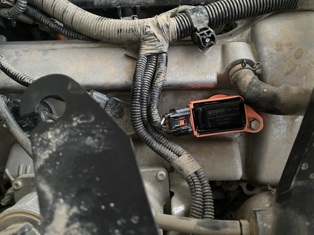

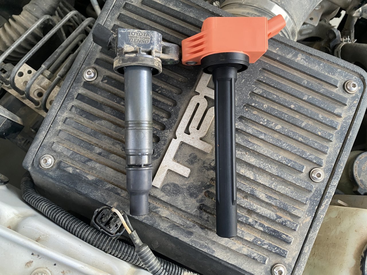

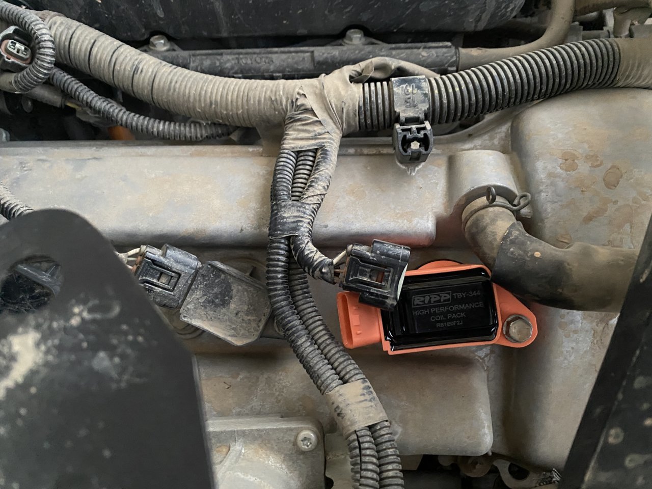

    They fit with no trimming. I will say it is a very tight fit and it will not fully seat until you tighten the coil down. I don’t think the rutheum spark plugs help us here because they are wider than normal plugs

    Is iit a "because the boots are dry and going onto a dry surface" issue?
    If so, a little silicone paste on the boots would probably do wonders.

    Mine had something applied to them from Ripp, but it seemed to be some sort of dry grease. I will try some silicone and see if I can get them to go in more better.

    Let me know how it goes. I may still take them off and trim a bit off the end. I think the issue is how the ends are a lot more narrow than the stock ones, and our spark plugs are fatties also.

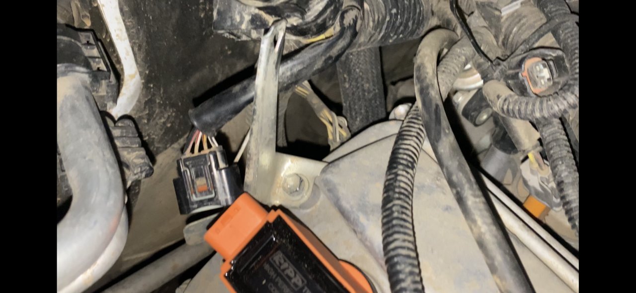

    Also just wanted to add I removed this bracket on the passenger side. 957AD037-63A1-4E8B-A589-A0875A6B6F4C.jpgToyota really didn’t leave a lot of slack with those coil plugs. A good and a bad thing lol

    You know the issue with that is that the bracket you removed holds the main harness. I'll have to take a look at it tomorrow and determine what the best course of action is with that one.

    I guess a bigger problem is the fact my main harness wasn’t even hooked to that. But there is another one a little bit closer to the fender and I clipped it onto that one so should be good enough for me.

    Do you have a picture of where you clipped it?
