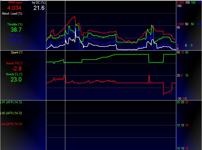

    nice! sun glare is blinding. maybe a welding mask is needed in cali:)

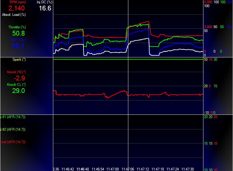

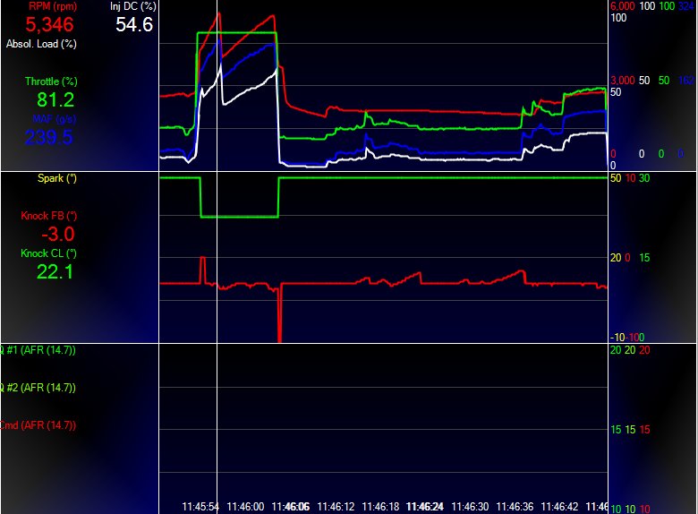

    I do it on purpose so you can see the AFR numbers. Actually. :)

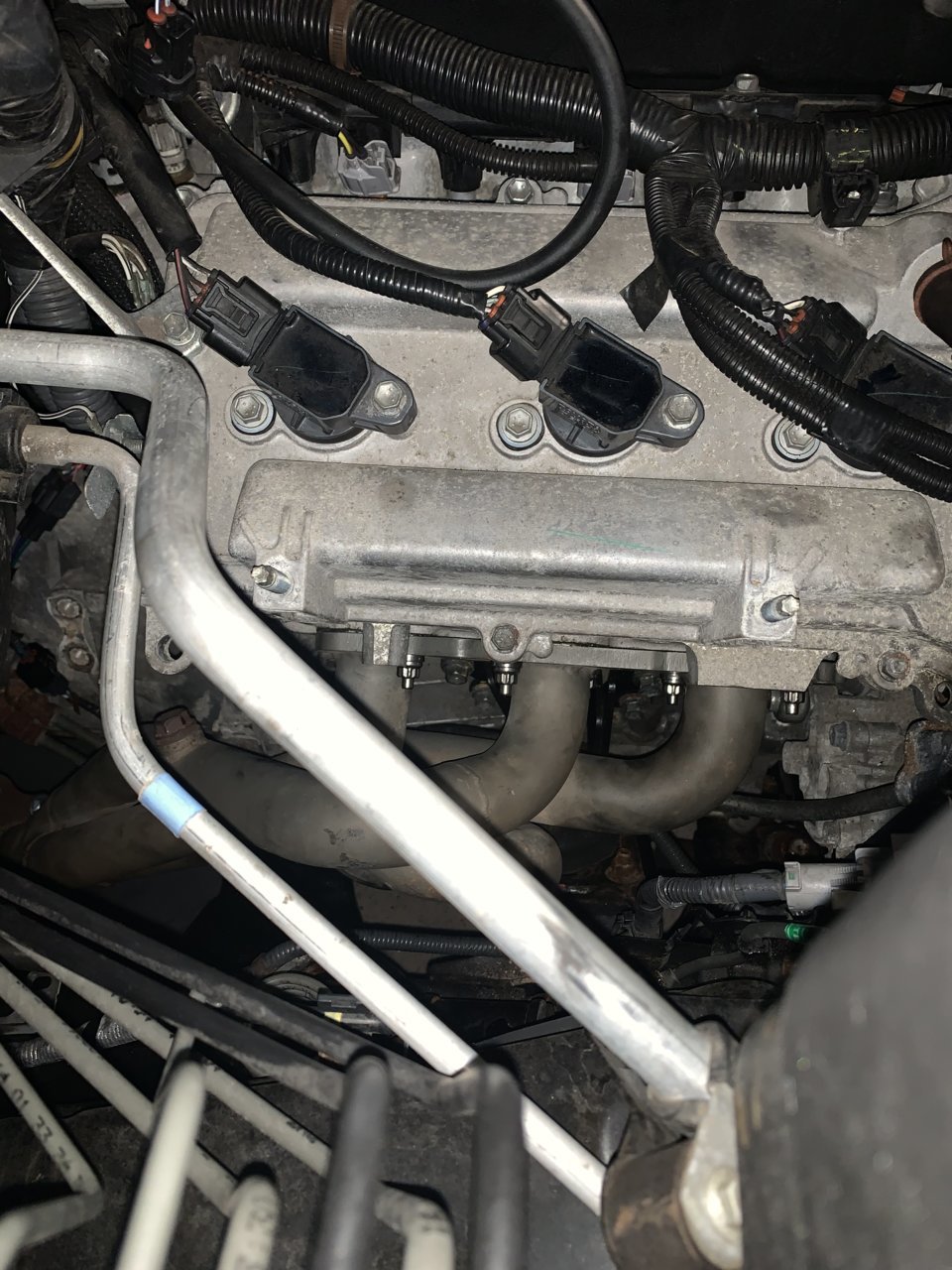

    Where do you have your AFR sensor mounted in the exhaust stream?

    Right at the end of the Y after the merge. I use a heat sink bung extender to prevent overheating of the sensor. This is probably the best picture I have of it at the time I took one. Which was back in 2015-2016 at this point. The piping has changed since but the position of it hasn't.

    If you are going to compare coil packs apples to apples then why not have much closer throttle output and MAFs.

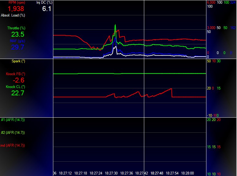

    I was hoping I had more data at the time of my previous log, however, when I was running it at the time I was looking for knock clean up more than anything and I had already ran out my testing, so it was more of a new log to track the changes for the decatting if any. Plus sometimes it's really hard to do runs based on traffic around me. I don't want to be "that moron" after all.
    Unfortunately as far as the previous logs go all I have is that one which I still have on file, as I deleted the old ones. The curses of having a low storage capacity laptop. (Seriously, this thing is almost EXCLUSIVELY meant for tuner purposes)
    I can say based on previous logs though, the knock feedback trend based on the sensor output is lower than it previously used to be.
