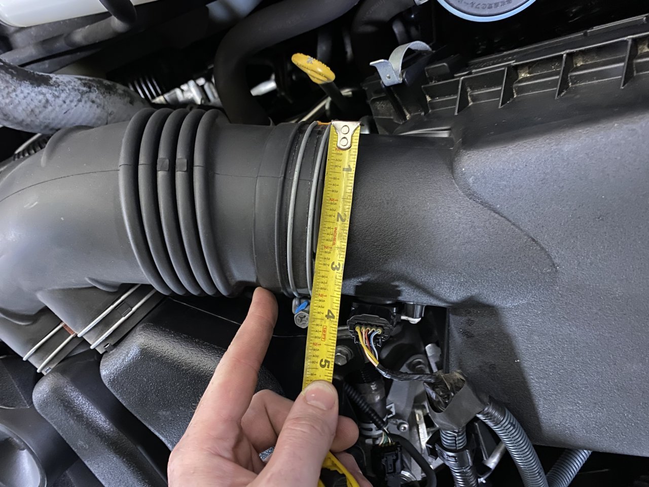

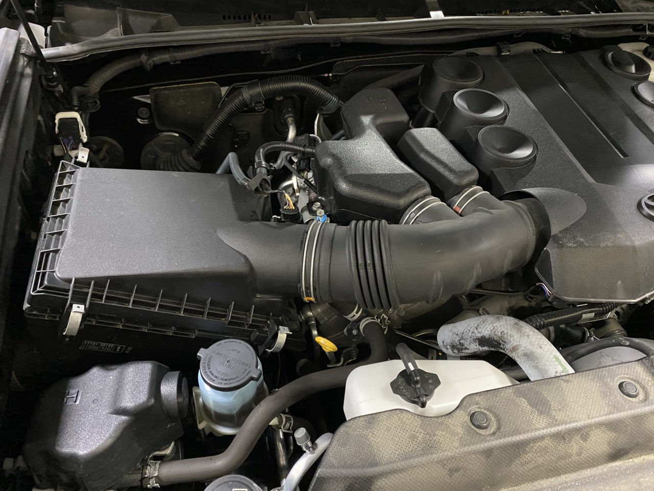

    Trying to figure out a different intake to run. Looking a. 2018 4 running intake. The pipe by the maf is 3.5” inside diameter. Seems like the best bet. And then u can get the K&n intake pipe from the stock box to the throttle body.

    It's all going to be work no matter which way you go if you want bigger which seems to be a great solution for our MAF voltage top out issue on the Tacoma intake setups. Page 1 has your solution.
