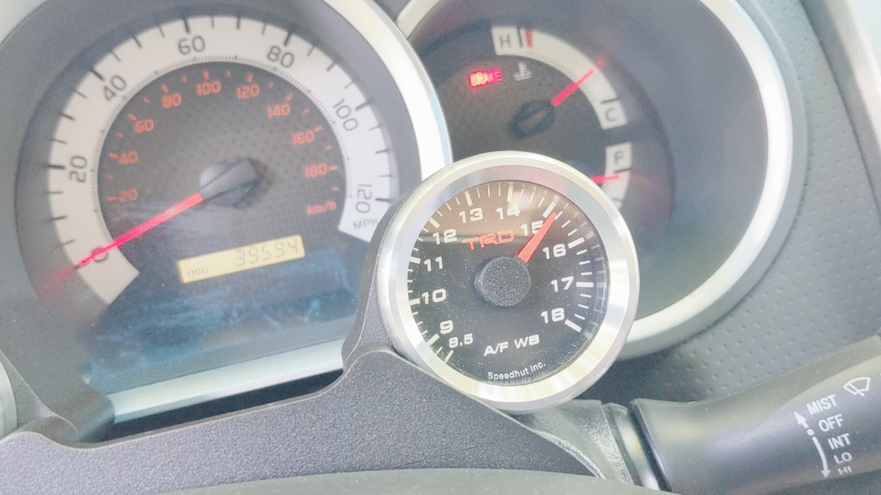

    AFR gauge went out today, hopefully just a faulty signal ground. Signal cable looks OK under the truck so far, but haven't opened up the dash yet.
    Illumination works (dial and needle), and the gauge jumps a quarter inch on ignition on, but sticks max counter-clockwise after that.

    Ok so checked everything, couldn't find any problems, fired it up and now is working.
    I'm thinking either I have a poorly insulated signal wire that was contacting ground, a faulty harness (possibly pulled a wire), or the O2 sensor is already going.
    Any thoughts?

    When my O2 sensor went out it was pegged at 10, wouldn't move.

    Interesting, thanks for the info. So probably not my O2 sensor then.
    Two more things:
    Does anybody else's jump around from 14 to 15 on startup? Does it about 5 times then settles.
    Also I'm wondering if I had the insulation around the sensor was too close to the bung, possibly it was trapping heat and overheated the sensor, moved it back and tied it, see before and after.
    Edit/update:
    Drove around for a while in the 95 degree heat, AFR gauge worked fine. Parked, shut the engine off, waited ten minutes to reproduce the preceding events to the issue, and the gauge is again not working exactly as described above.

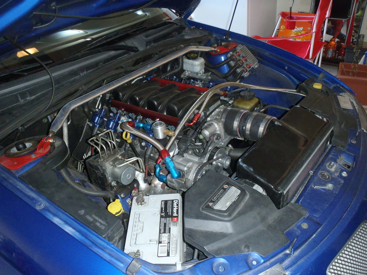

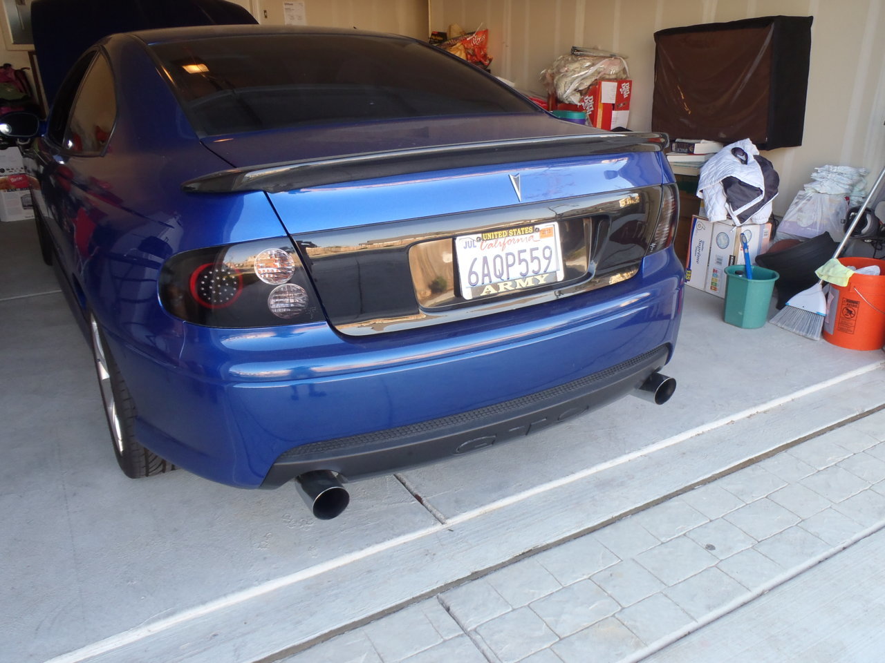

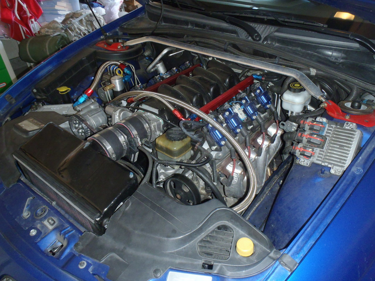

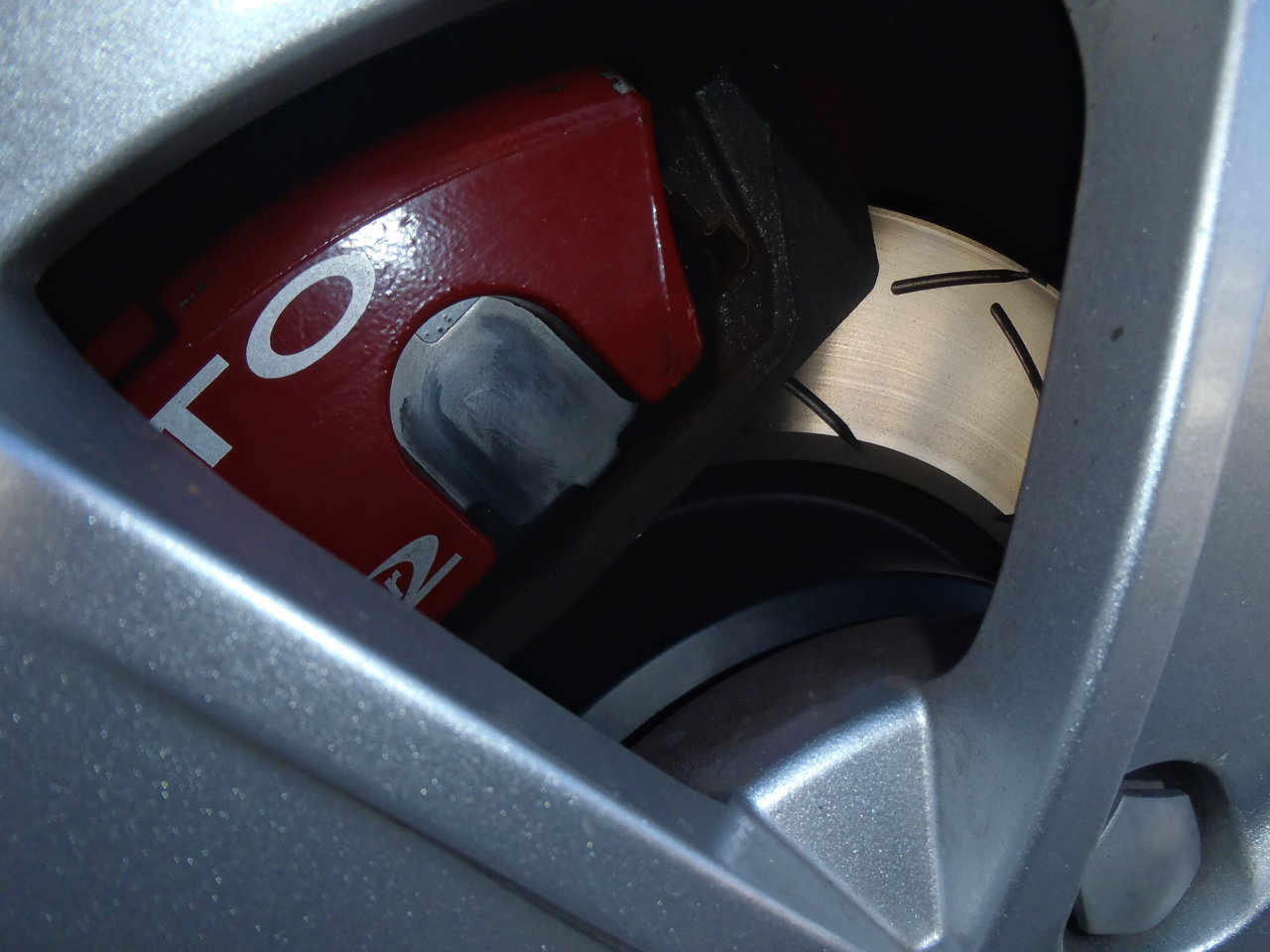

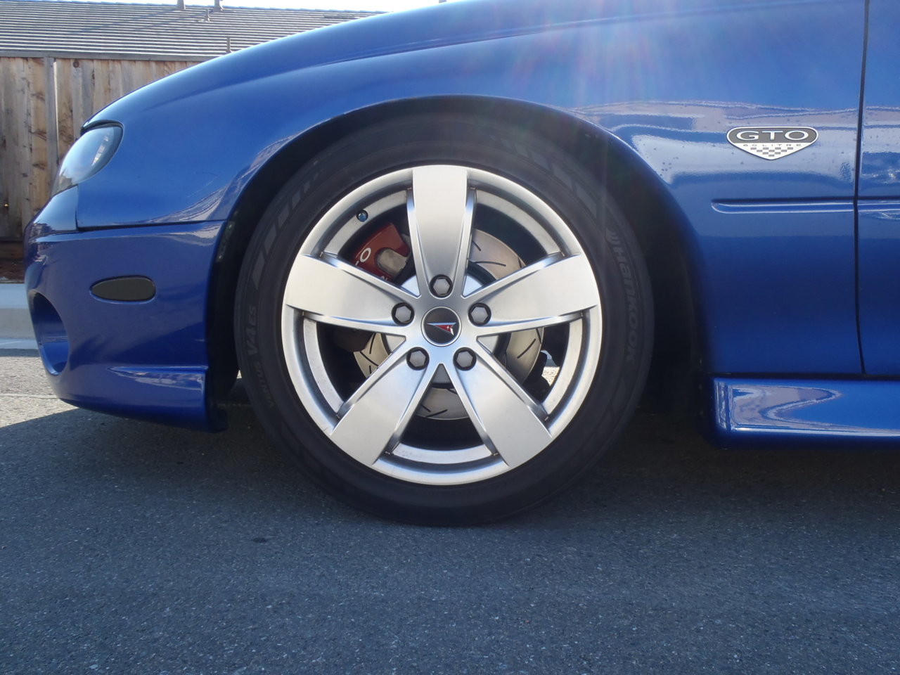

    I know this is late since others posted their rides a while back, but here is some old photos of my muscle car glory days of my GTO as well as a build list prior to making the switch over to this truck build. This was one nasty 6.0L. I miss the power, but I don't miss the problems.
    - HPTuners w/ SD tune
    - Comp Cams 232/228 .574/.569 115 LSA reverse split cam
    - Typhoon intake manifold
    - Svedespeed Over The Radiator intake
    - GZ Motorsports vacuum pump
    - Yella Terra roller rockers
    - ASP lightweight crank pulley
    - Borla X-pipe
    - Corsa DB Red mufflers
    - race built 4L65e transmission
    - Yank 3500 stall converter
    - Driveshaft Shop aluminum one piece driveshaft
    - Eaton Tru-Trac IFS
    - Hinson polyurethane engine mounts
    - Team SCSS polyurethane transmission mount
    - Pedders fully adjustable coilovers
    - Hawk slotted rotors
    Don't mind the junk in the garage, we just moved in at the time.

    Gave it some time to cool off, working fine again. Pretty sure my O2 sensor is crap as @12TRDTacoma describes. Will be purchasing a new one to see if that solves the issue.
