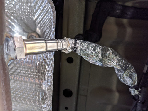

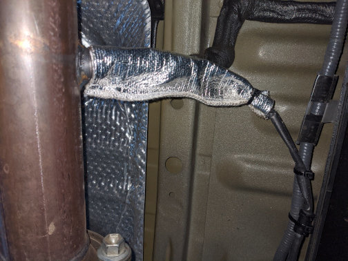

    Oh yeah, and do yourself a favor and get an o2 sensor bung heatsink. Eliminate the heat failure variable.
    EchoLake[QUOTED] likes this.
