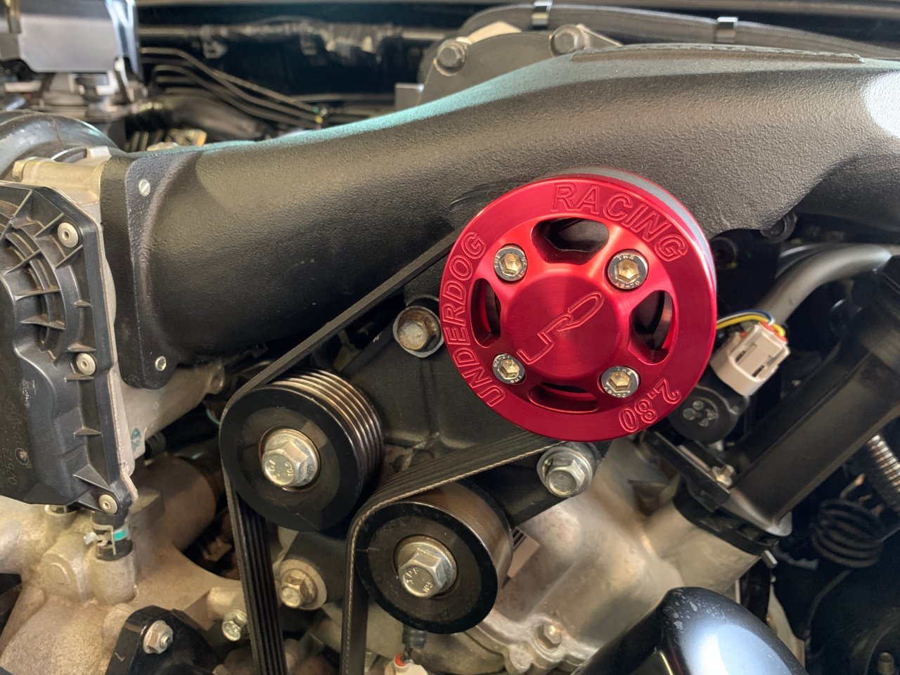

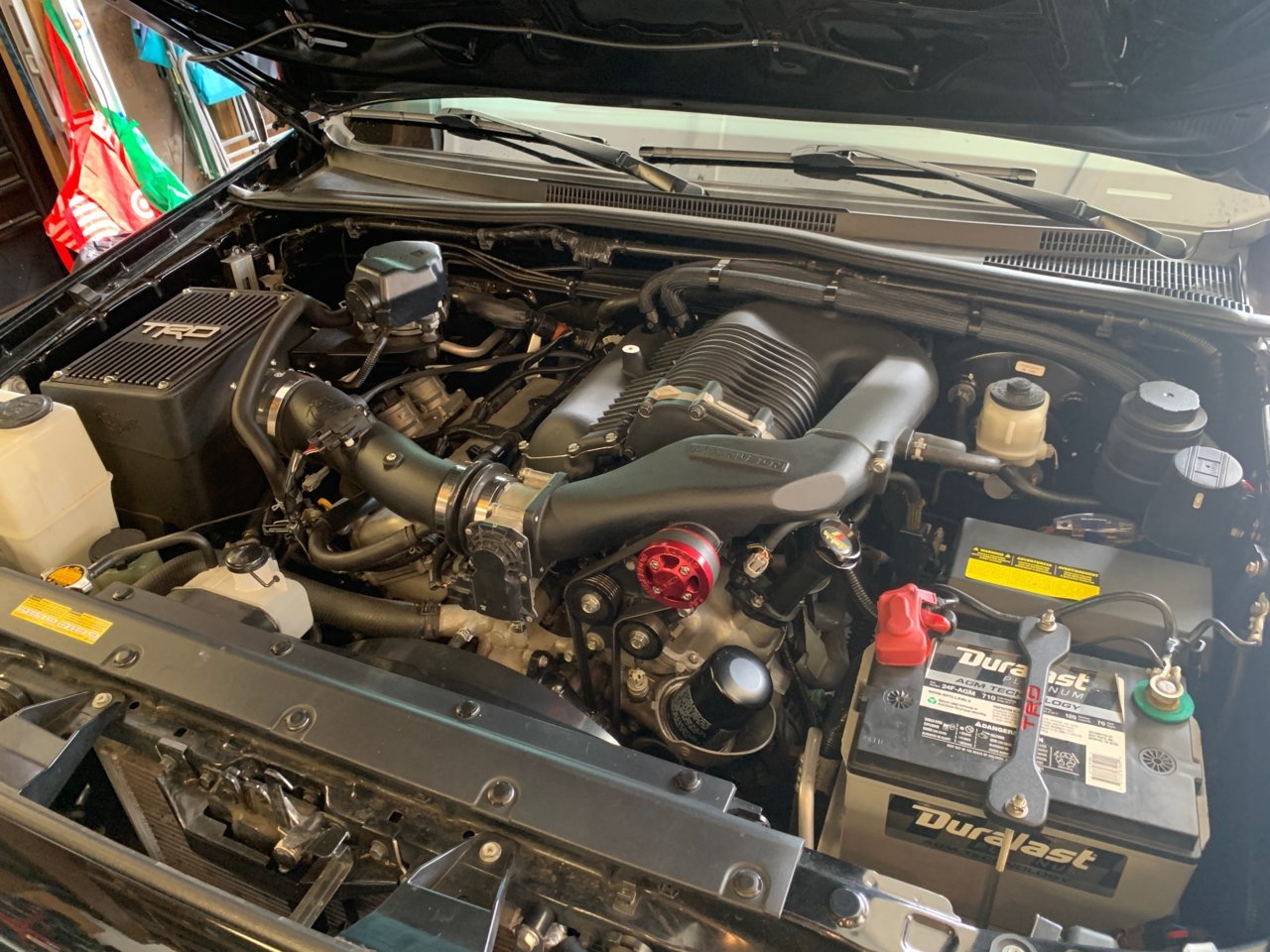

    Just installed my 2.8 quick change pulley. I was worried about the install but turned out to be a breeze.
    I also feel your pain on the dirty engine bay, mines gonna need a good cleaning soon.
