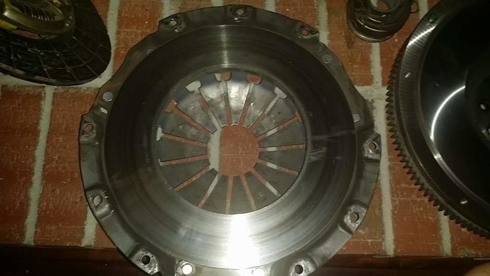

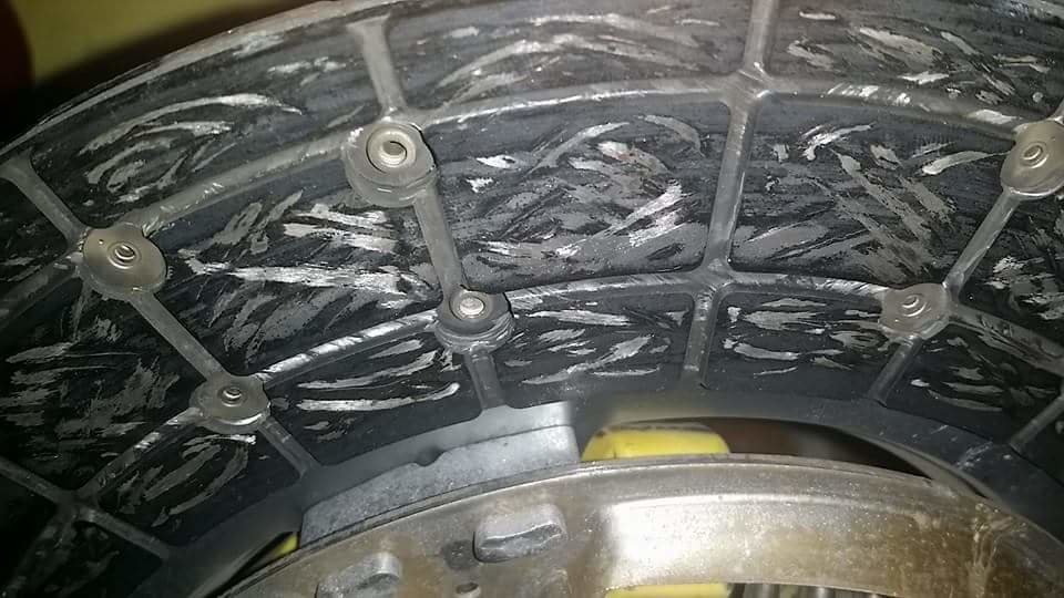

    Was not happy with the chatter and jerky lockup on the stage 3, went to a stage 2.
    Next time I am going to go with another brand, the 2nd URD came with a competition clutch sticker. I have never liked that company. That and both URD clutches had really poor powder coat job's. They claim improved clamping and higher lift, but side by side with the OEM pressure plate it looks identical just with a flakey powder coat job.
    I would have gone with the centerforce, but they don't have a clutch set that is specific and I did not want the gamble.
    The URD pressure plate, in adition to flaking powder coat I had to clean the bolt holes out because they were not clearanced to work with the bolts. On first install I did not look close enough and it torqued down without seating all the way.

    Stock pressure plate at 6, great shape just could not hold the powerFB_IMG_1523751629580.jpgstock disk

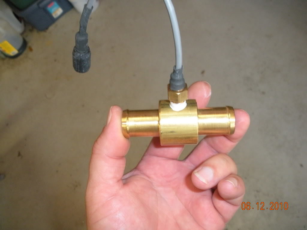

    Mine are not so fancy. I measure the water temp in the surge bottle and the hose .
