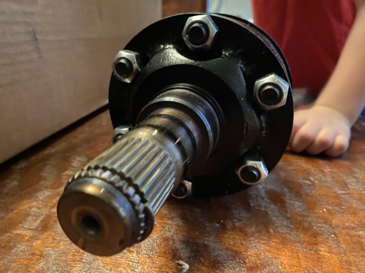

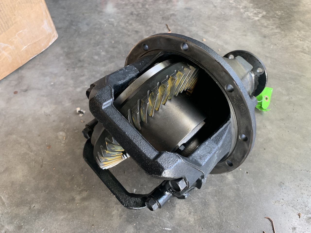

    I was greeted with this at my door when I got home today.
    19AEA72D-D12F-4788-BF56-C20DBF94E6F7.jpg 473A0793-0E72-40E2-9D0B-67015A1D25F2.jpg

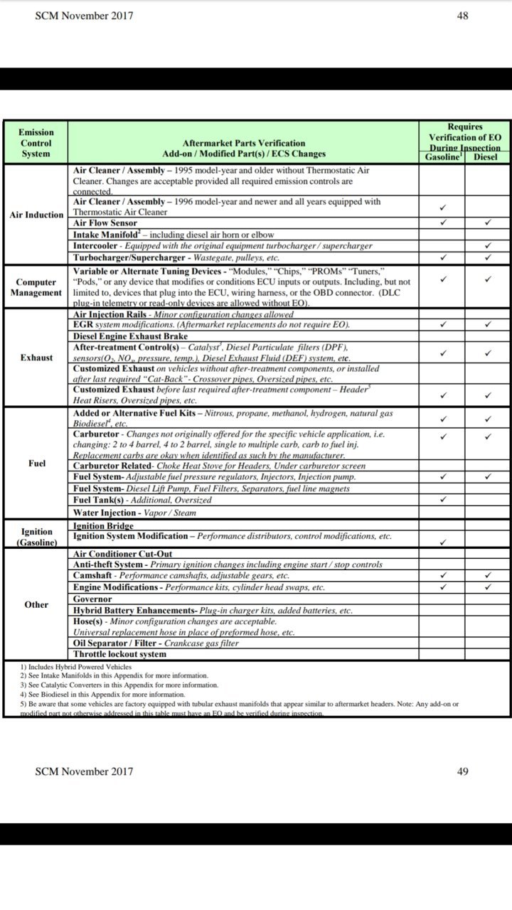

    Did a bit of searching and it seems water is “fine” but might depend on the smog tech.
    AEM has a CARB approved water injection kit. No mention of methanol.
    https://ww3.arb.ca.gov/msprog/aftermkt/devices/eo/d-392-35.pdf

    That would not fly since the tacoma is not listed if we were looking for CA carb friendly.

    Nice! 4:88’s?
    Got a little axle work in the mail too. 934 cvs adapted to stock inner stub shafts and 300m axles. Can’t wait to try these out. Thanks @81Trekker 0A7CBF5E-97B7-4329-B64C-EFE218C856B0.jpg

    Nothing that extreme. Just compensating for larger tires. 4.10 w/ Detroit Truetrac.

    i love my 4:10s and trutrac. i think its perfect for my 285's. nothing extreme but just a nice stock balance.

    That kit is vehicle specific, and the Tacoma is mentioned nowhere in that Executive Order#.
