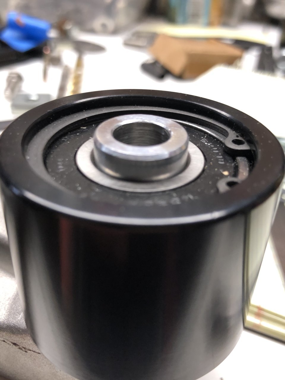

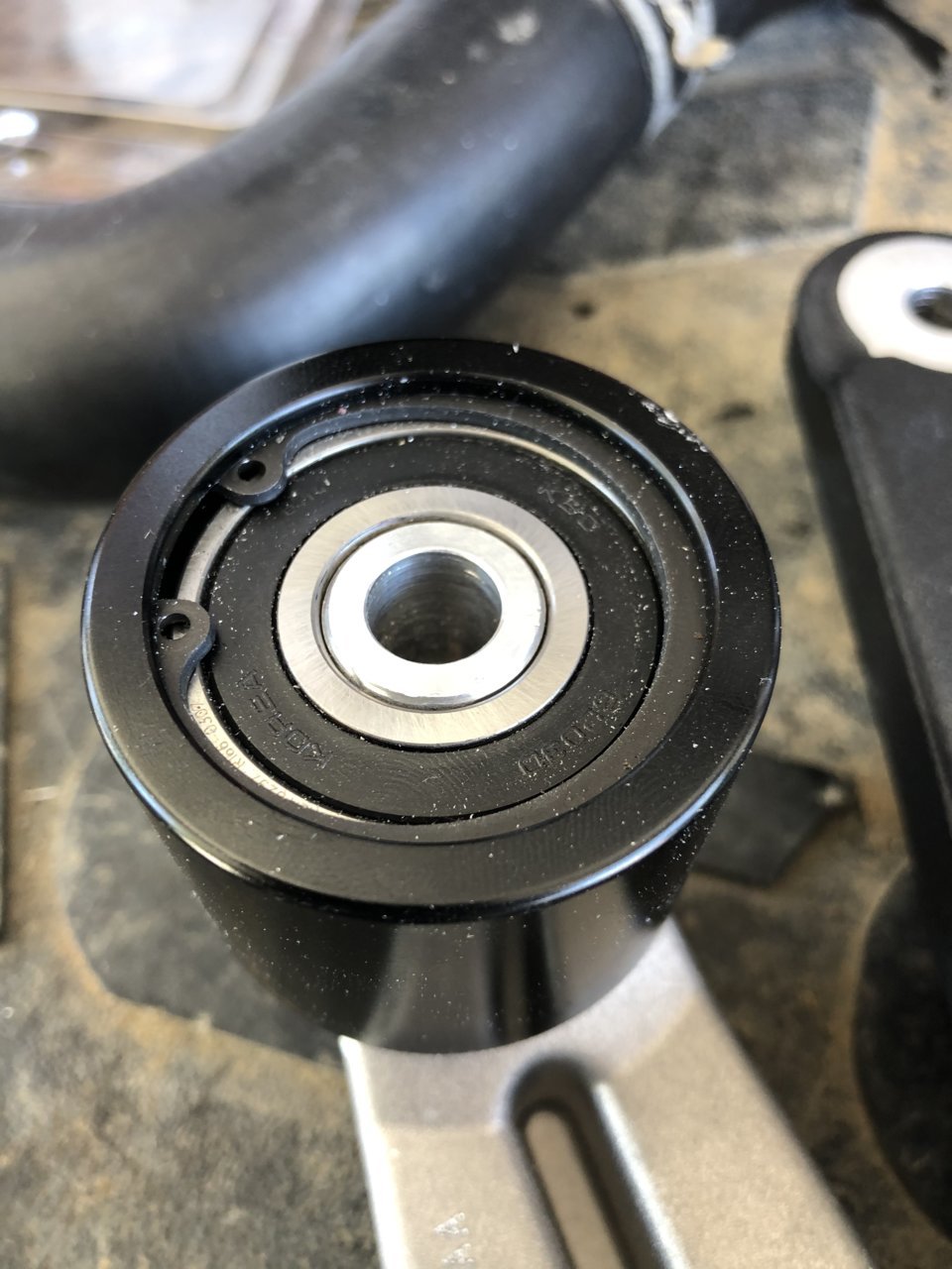

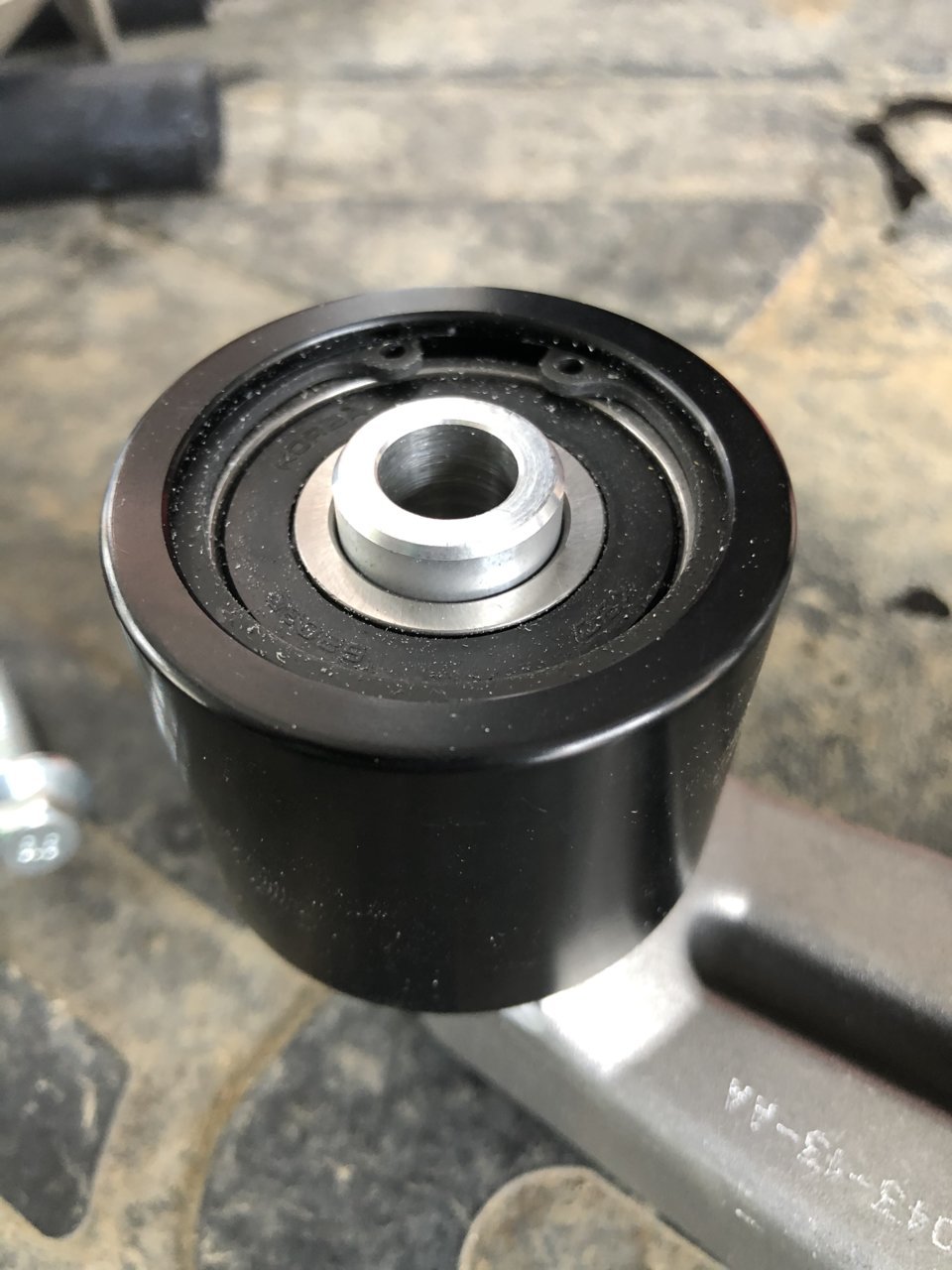

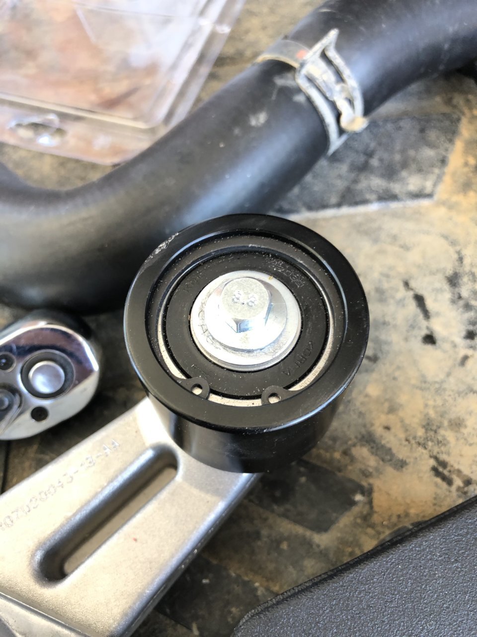

    Wondering if you got any of the correct size spacers? I already have the pulley and spacer but would happily just buy another that's the correct size.
    Tensioner should be showing up today.

    Thanks for the photos.

    I did not get correct spacer. Could probably get one made but I was worried about precision in my measurements. Instead I used a electrical conduit clamp screwed to board and cut the AL spacer with fine toothed carbide saw in my chop saw then sanded edges smooth. I posted picture somewhere in this thread. Since spacer is AL it cut through like butter but I probably wouldn't use a fancy Forrest blade but the used Freud one I had was just fine.
