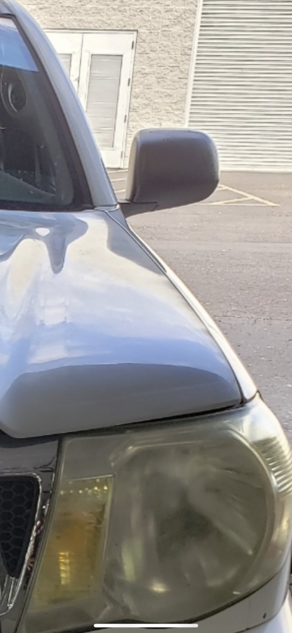

    They built mine in six days. I picked it up there in Murrieta. Saves the $200 shipping charge.

    how is the fitment? I'm a little concerned that an aftermarket hood mounted to aftermarket fenders might have some pretty knarly panel gaps.

    I did a test fit before painting. Gaps to the OE fenders weren’t bad. Couldn’t close the hood all the way at that point since I still had the old headlights on there. But, for a fiberglass hood, it was a surprisingly good fit.
