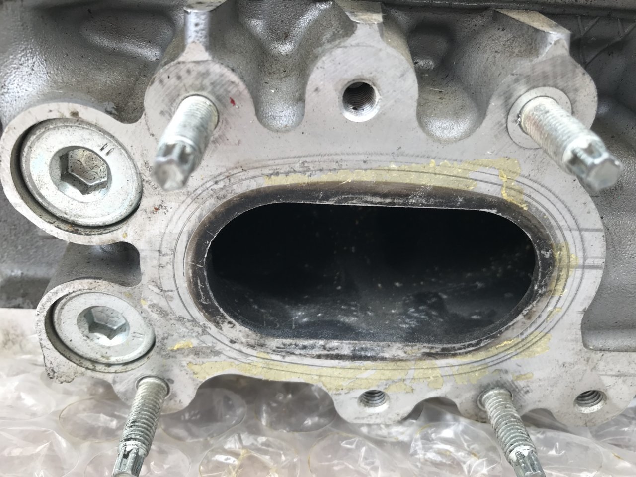

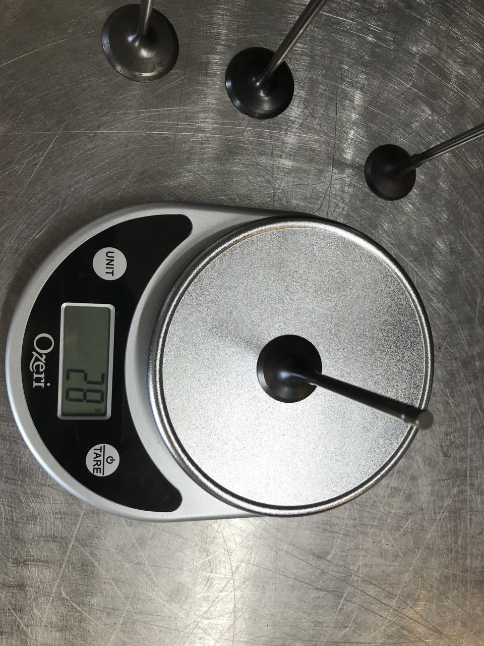

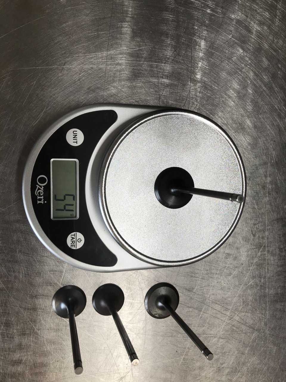

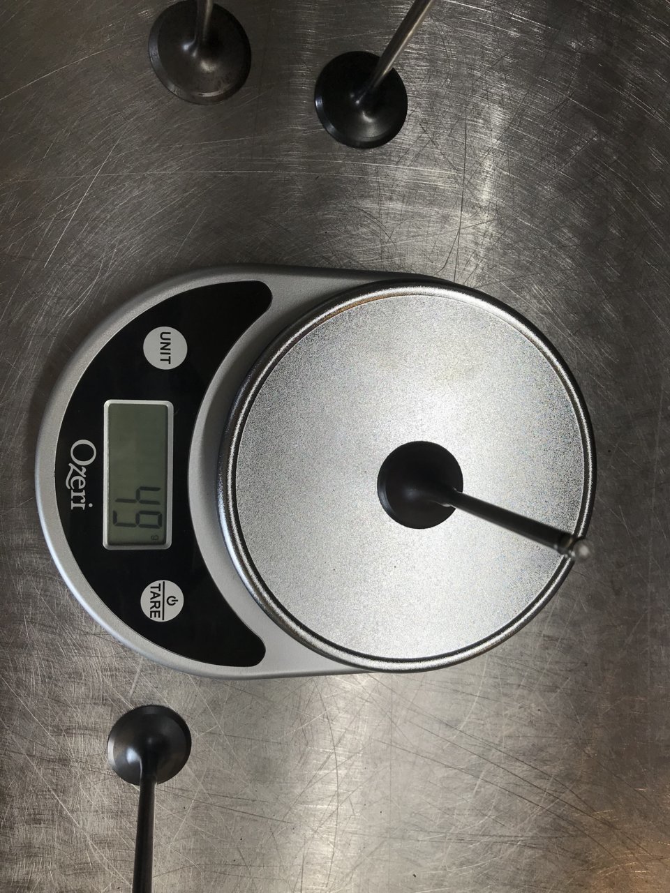

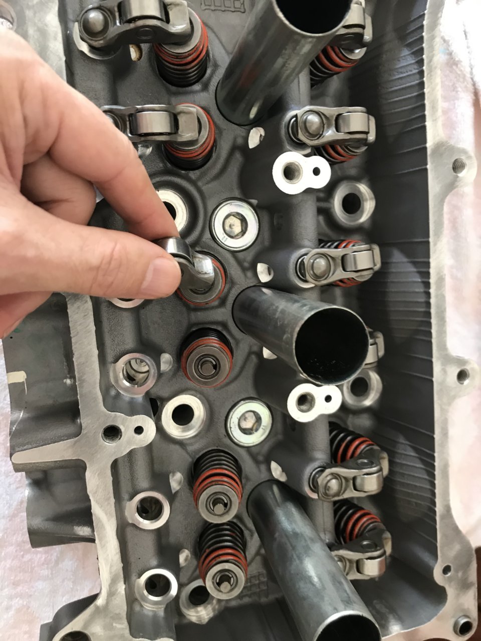

    No, the valves are OEM Lexus valves from the LC500 and the springs are the same as the OEM Lexus springs so there was no need to change the springs. The lighter valves will prevent valve float and valve bounce at higher RPMs. At normal RPMs I could have used softer springs but the whole purpose was to be effective at higher RPMs. The red line on the Lexus LC 500 is 7300 which has a large safety factor built in which is why I think I can safely raise it higher. I don't have a small scale so I weighed them in Wichita Falls last year while @Roostfactor was making my JFR y pipe. The scale in the pictures is Roost's scale.
    Edit: I have to thank @Jowett for letting me know about the Lexus titanium valves being compatible with the 3.5 engines. I paid only $463 from a Lexus dealer for all 24 valves which would have cost around $5000 to have them custom made.

    Check out the 2UR GSE cam followers, too. They have a hole/oil jet that sprays the roller directly.
