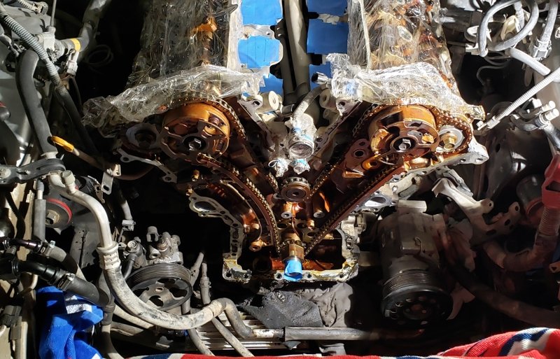

    3/4 way to pulling the heads for fresh gaskets. Figured it was better to do a poor man's rebuild than pray it'll hold. Thanks to you guys for sharing your experiences. I'm definitely way past budget and better off for reliability (as far as the wife needs to know). Ordered a Roush 404225 tensioner for under $140 using code "iknowbill" for 8% discount. Covered tax and it's free shipping.
