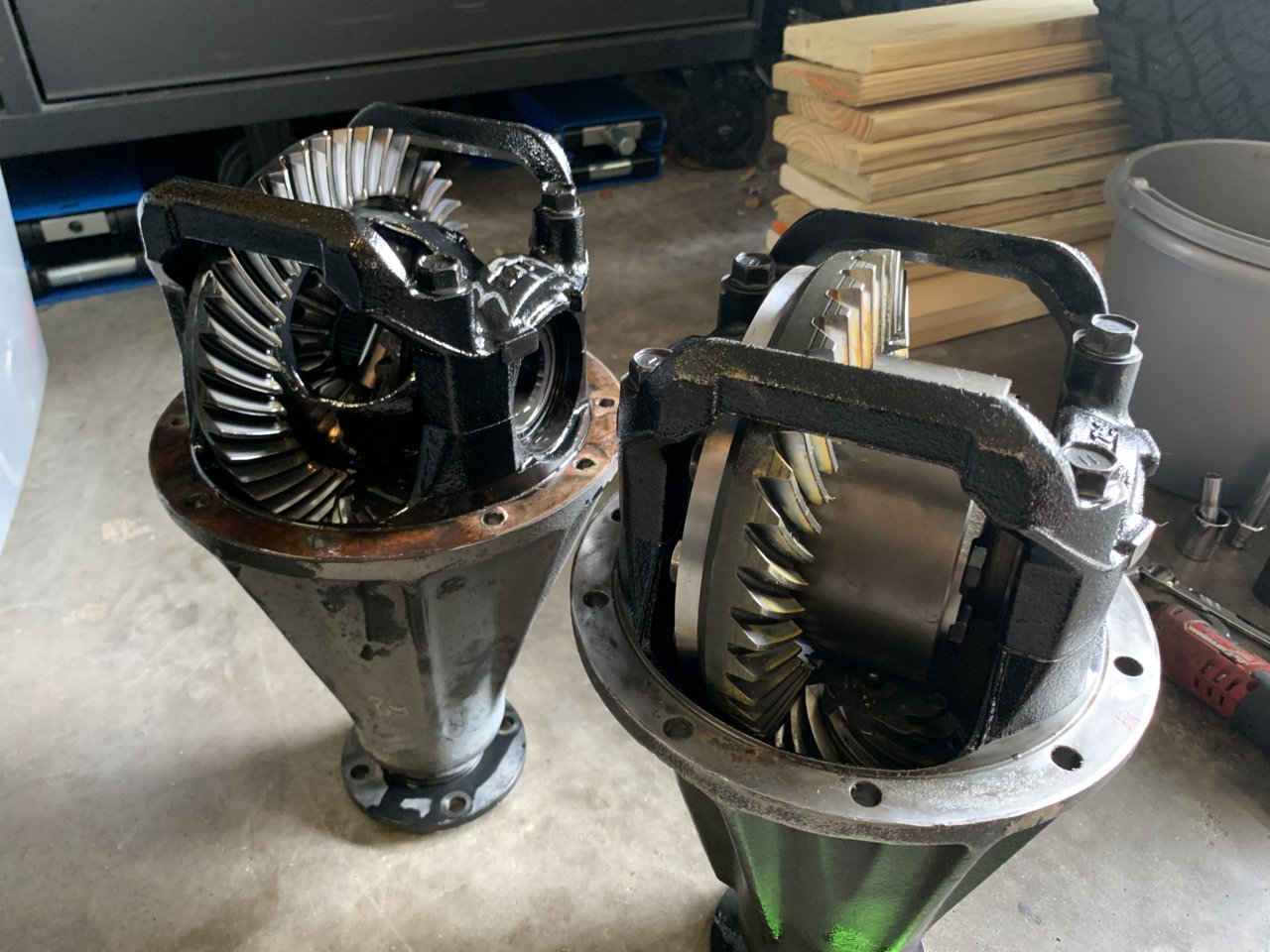

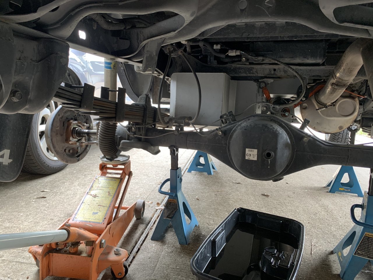

    After some cruising around today, I’m stoked on the 4.10 diff! Perfect for my mall crawler setup with 285 tires. It provides a nice improvement in acceleration and an acceptable highway RPM. I originally planned to do 4.30, but I think that would’ve made the highway RPM higher than I’d like.
    I still need to swap the front diff, but I ran out of time for this weekend.

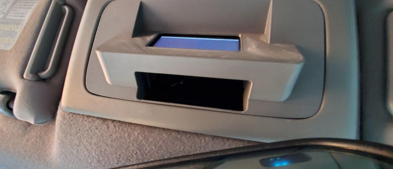

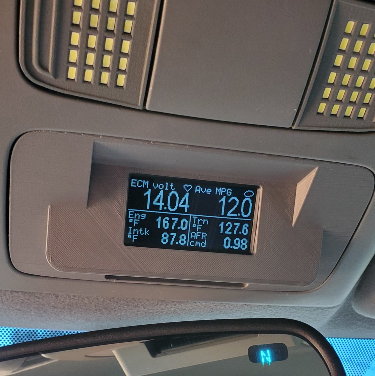

    I still like my ultragauge mount from @BenCC
    Especially, the new revision that allows easy access to the Menu/Arrow buttons on the back.
    Line of sight to the digital reading(s) isn't ideal but the factory looking integration into the overhead console is what appeals to me.
    The idatalink/maestro method discussed by @loginfailed is the best IMHO, but I didnt have a compatible head unit and didnt want to upgrade.

    That is pretty slick though always available even compared to the radio.
    I swapped I’m an android head unit and it connects to my BT OBD reader. Was debating on the ultra in a similar manner
