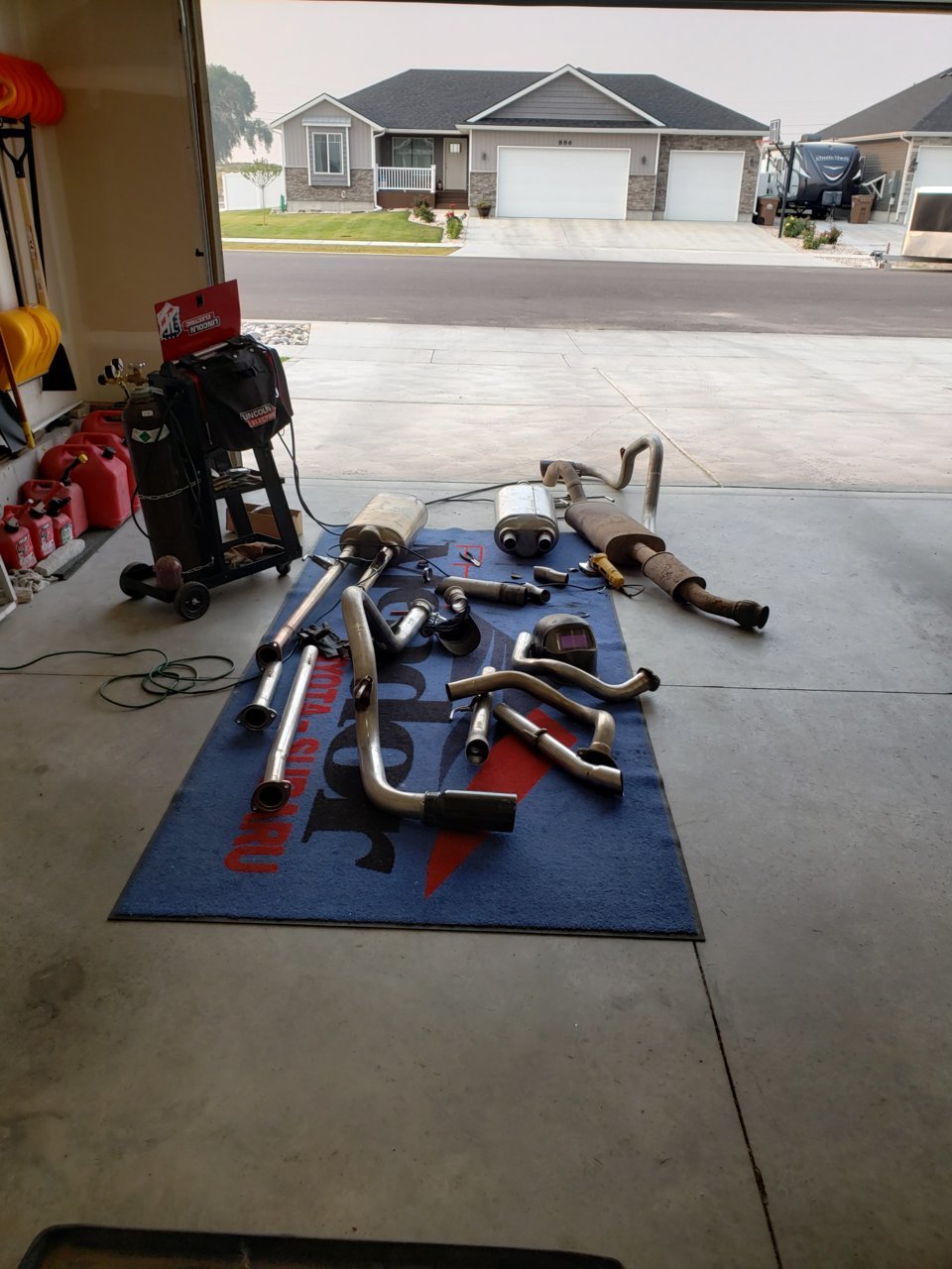

    '06 S/C 1GR-FE DCSB
    Icon coilovers w 14" 700lb springs, Icon billet UCA w/ Delta joints, custom built Icon rear resi-shocks, Icon stage 3 rear leaf pack, Archive Garage Hammer Hangers w/ homemade spreader bar, superbumps up front and timbren bumps in the rear, Crown brake lines, U-bolt flip,4.88's with front ARB locker and ARB dual compressor mounted behind back seat, 285/75R17 BFG A/T KO2's on Bronze Icon Alloy Compression's, 5th gen T4R budget big brake kit, CBI Off-Road Fab. custom Trailmaster 2.0 with swing-away tire carrier, CBI custom tube front bumper, CBI kickout sliders, CBI full flat belly skids including gas tank,CBI Ditch Light brackets w/ Heretic Studio Quattro's, Heretic Studio's 30" Amber on the front, Heretic Studio 40" bar under the Front Runner Roof Rack, Expedition Essentials RAM mount, Leer used shell, OEM black chrome sport headlights, fog lights always on mod, rear locker anytime mod, TRD supercharger, URD Ucon-EMS, Deatschwerks 255 fuel pump w/ URD external fuel filter kit, AFE intake paired to a Safari Snorkel, URD spec-U exhaust w/ factory Tundra muffler behind URD equal length headers.
    2" in and 2.5" out.

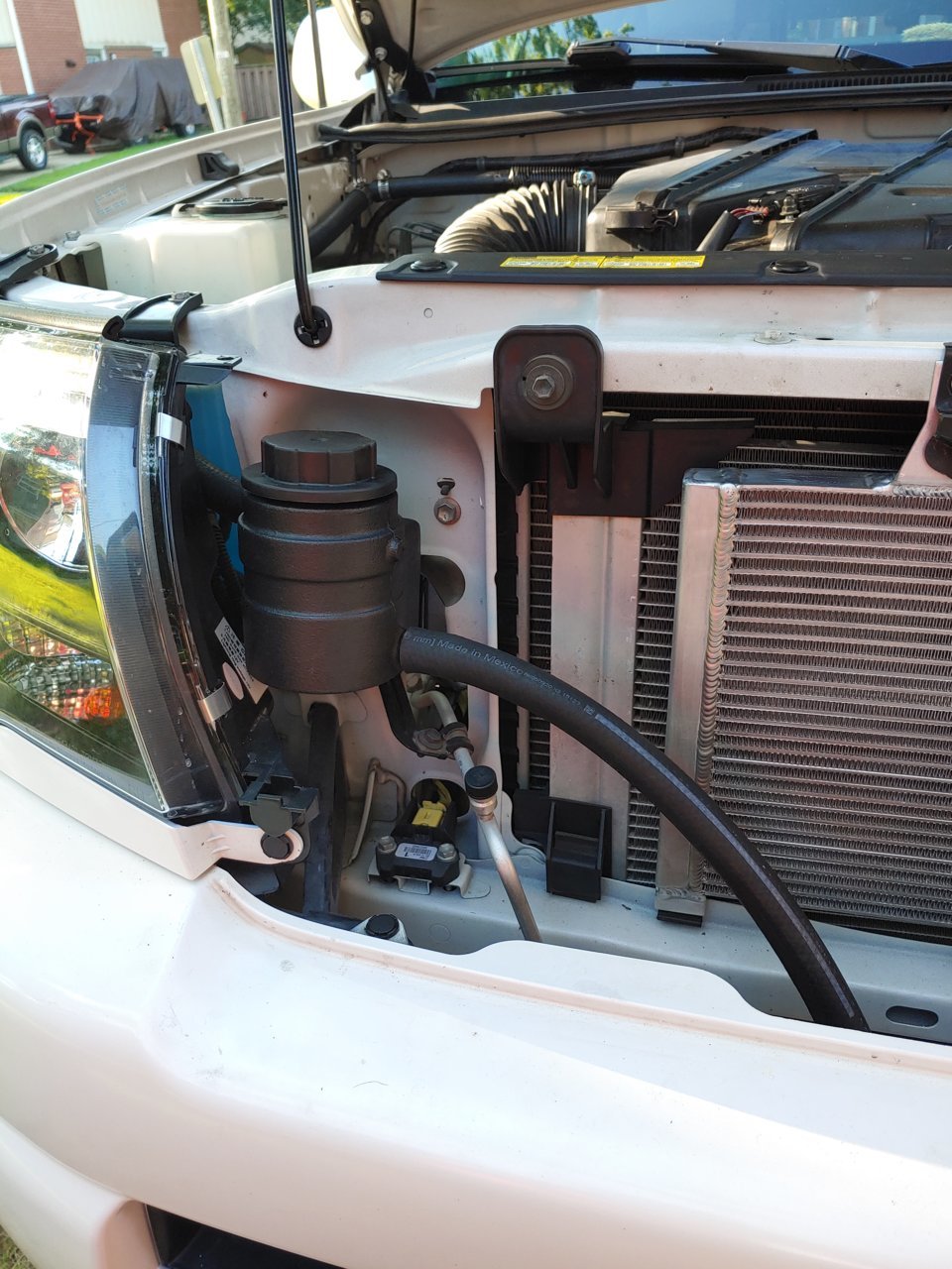

    Went with this for now. Flow is good everything fits. Just bent a 90 in one of the supplied mounts.0825200837.jpg

    That may work but you may end up with air pockets in an undesired location.

    findingthingsout
    findingthingsout Well-Known Member
    Dec 15, 2014
    #144330
    896
    midwest
    08 Tacoma TRD O/R A.C. MT
    Boost, armor, lights, big tires, no savings.
    How hard is it to access the lid? Do you have to pull the grill?
    There have been very few reported failures with the S/C system, one is either running low on coolant or the pump failing. I like to check the level and see the coolant move on a regular basis. My two pennies...

    Lid is right there behind the grill. This was taken before I finished up, but you can check and fill with the grill installed

    I got a power tray and cut a notch out the back so it fits next to the reservoir. Looks like it will work with my shiny new coolant reservoir too!

    isnt the s/c coolant resi supposed to be the highest point in the coolant loop? I think i remember reading this somewhere, like Dwayne said, to keep air pockets out

    It's easier to flush out all the air if it is the highest point in the loop.
