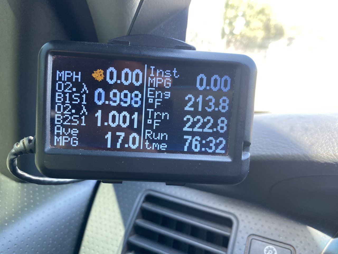

    I'll take the 17.0mpg avg anyday.... but you can keep the 213F H20 temp and 222F trans temp.
    This weekend is a scorcher temp-wise for CA standards......is that what's causing the higher than normal water/trans temps? Or were you towing or found yourself in Mexico and now letting it cool off on the side of a road?

    The truth is you will find this issue with many if not every other manufacturer out there as far as trucks are concerned. GM is no stranger to high transmission temperatures and the trannys ultimately fail early due to high heat and shitty inferior metal and material usage issues.
    As far as those temps go Anthony, if you weren't towing check your intercooler pump and make sure it is on and working.

    Don’t be fooled, I had recently filled up. The temps went up to 221 engine, 230 trans just chillin
    No I was driving normal and then I went through the chik fil a drive through. Obviously I was asking too much of the truck.
    Intercooler is working. I was in a drive through. I think I am gonna get a duramax.

    man I feel your pain. My truck does TERRIBLE on temps when I am stationary since moving to Texas. The heat is just too much for the truck to cool itself.

    Fan clutch.
