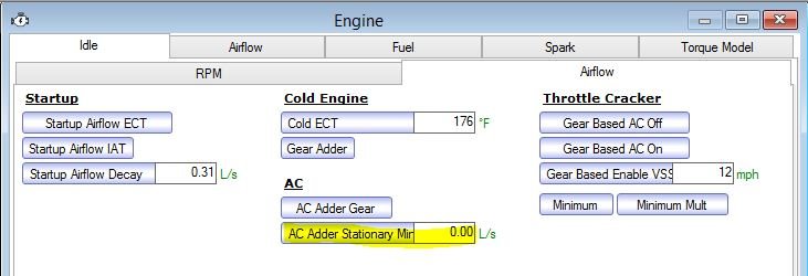

    Hey @JustDSM
    Can you set things up to make the truck idle a bit higher in the heat? Like say, in a drive thru, or idling in a parking lot in neutral. I’ve noticed with my truck, the ac runs much cooler with the revs at say 1100 instead of 750.

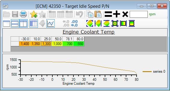

    I can set idle RPM against coolant temp for both with the truck in neutral or in gear independent of each other.
    [Edit]
    There may be a way around this to some degree.. In the Idle/Airflow Tab, there is a specific parameter that will allow you to add a given amount airflow while stationary at idle with the A/C on. I've never experimented with this, but check out this parameter:
    Adding some airflow here may do what your looking for without having to raise the base idle speed ALL the time... Hmm Anyone want to test?
