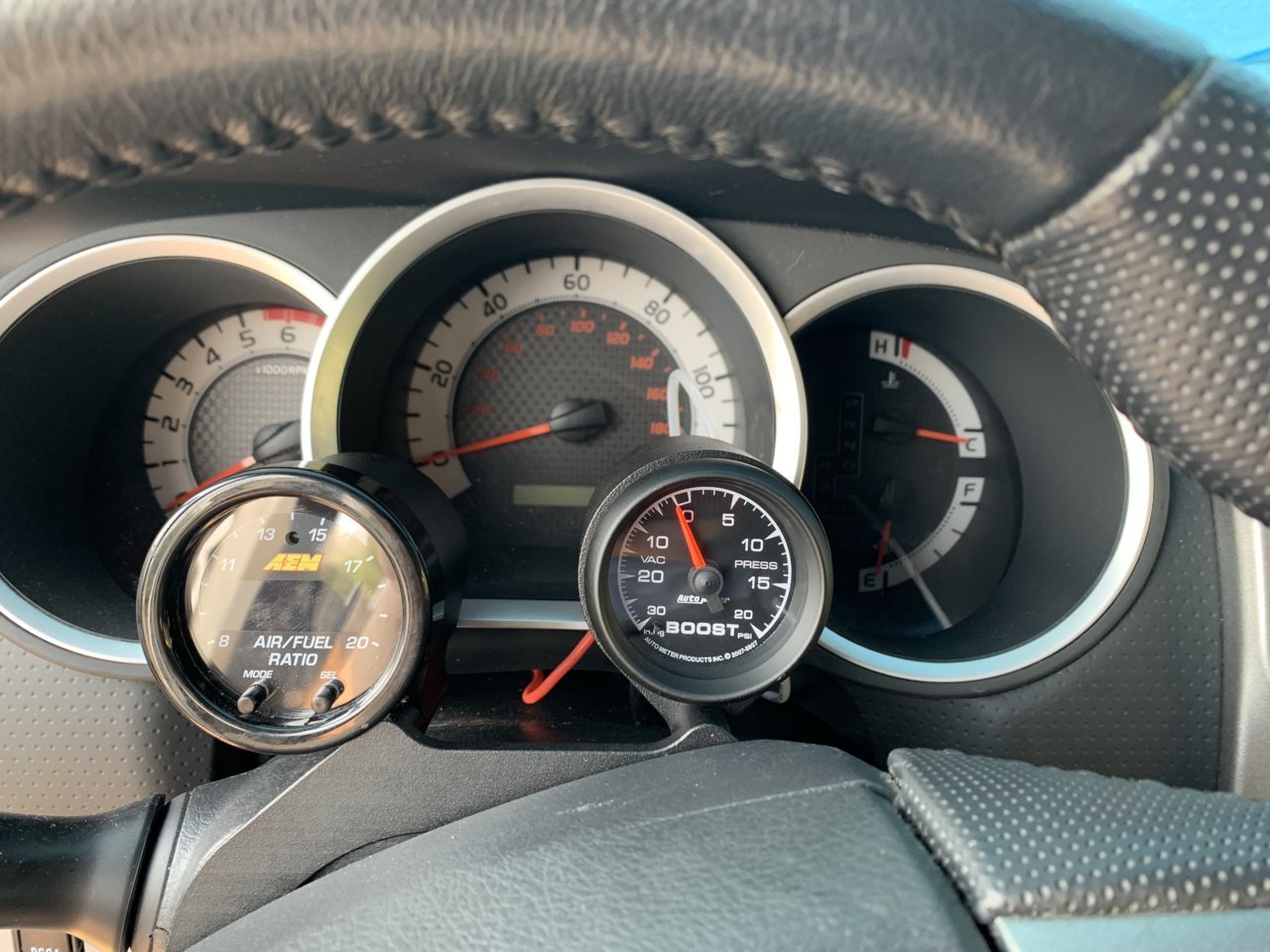

    So after getting tired of my Innovate Boost gauge acting like a hunk of junk and tech support telling me to buy a new pressure sensor for $40 (it never worked right), I decided to swap out for a mechanical boost gaige from AutoMeter. Settled on the Autometer 5907 ES, 30inHg to 20psi.
    I am sure if I had dug a little deeper aside from looking at the gauge diameter and scale, I would have realized just how deep this thing is. My plan was to mount it in my gaugepod, and I did, but I am not overly happy with the setup. Livable for now, but definitely is going to change later.IMG_6719.jpg IMG_6720.jpg
    So off come the bolts on the back. Pull the wiring and tubing up through the dash, and since I have things halfway apart why not pull the gaugepod out far enough to get in back and snug up the pod bolts.
    Naturally I am sweating like crazy, my allen socket slips out of my fingers, drops between my steering column and dash, only to enter the place of that small things go never to be seen again. Fuck. I will see you again someday my friend.
    Not loving the way it sits, but the connections in back present an interference to the instrument cluster.
    It comes with nylon tubing, also not loving that. It kinks easy and is not very forgiving in bends. I will probably change the nylon tubing out for silicone soonish, and ultimately find a new home for the boost gauge and try to settle on what should go in next to the AFR. I will clean it all up when I redo the tubing, right now - good enough until I take it apart again.
    Initial impression after a short drive - Tracks much smoother than the Innovate and does provide an indication that seems to be in line with what I expect. The innovate would lock at 0psi and then jump like crazy under boost.
    Since I am talking about gauges in the gaugepod... Here is the notch you have to cut in an AEM gauge bezel to make it fit into the gaugepod. You can only see it if you are right in there looking for it.
    ROACHYMANG likes this.

    Snow performance stage 3 has built in boost gauge. Just saying :thumbsup:

    It was the pressure sense bro. You should had just gotten it. I have been using my innovate boost gauge for close to 5 years now and it has always been perfect. The fact it spiked from 0 to a ton of boost all of a sudden tells me that the diaphragm inside the sensor was sticking. :notsure: Oh well I guess.

    Easy enough to go back with a new sensor if get fed up with the Autometer.
