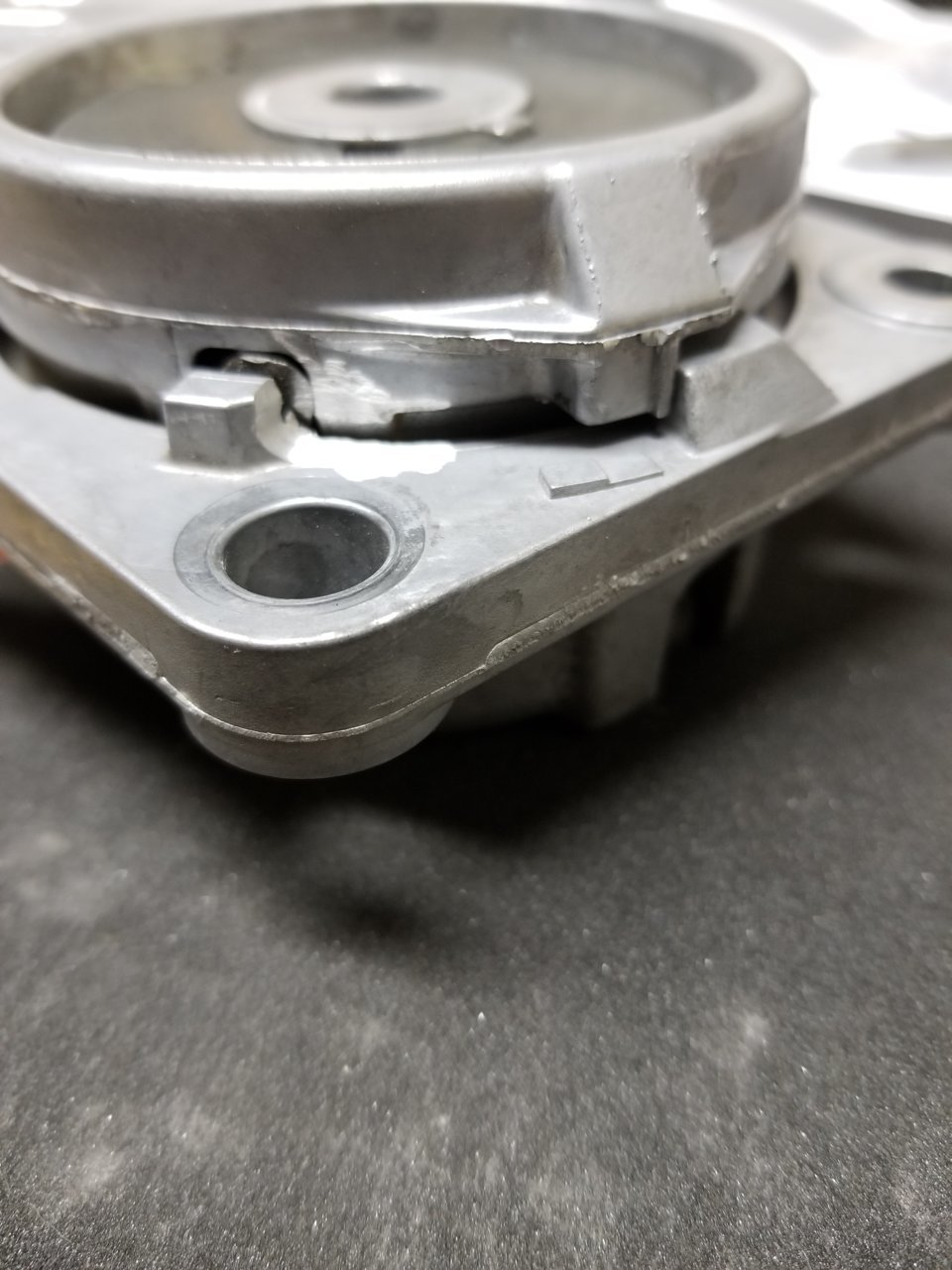

    The only thing is that factoring in belt stretch, the 69.5" easily stretches what seems to be at least a half inch to an inch over a short course of time. So a fresh belt is a little annoying to put on over a already broken in belt. So maybe 69 MAY actually not be so much a bad thing for the 2.5 guys.

    I personally still have a slight struggle to get my 69.5 on the 2.5 even after a couple thousand miles. Gotta muscle it on every time.

    Possibly but the RPM belt supposedly doesnt stretch. Not my experience but from others who had installed them in cars with manual tension adjusters. They said they kept popping their hoods checking them since they were so used to having to adjust belts and they found the RPM belts didnt stretch.

    Next time you have the tensioner off try shaving the stop down like this. It will allow a little more room to install the shorter belt.

    I think it is wise to do the mod with anything smaller than 2.7. 2.85 may require a fresh belt to keep things honest or if you are adamant about using the 69.5 belt with a 2.85, you are best off doing the tensioner stop shave mod @Roostfactor has shown on here.
