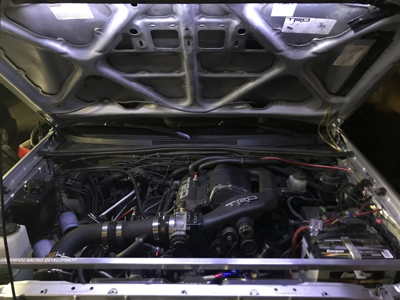

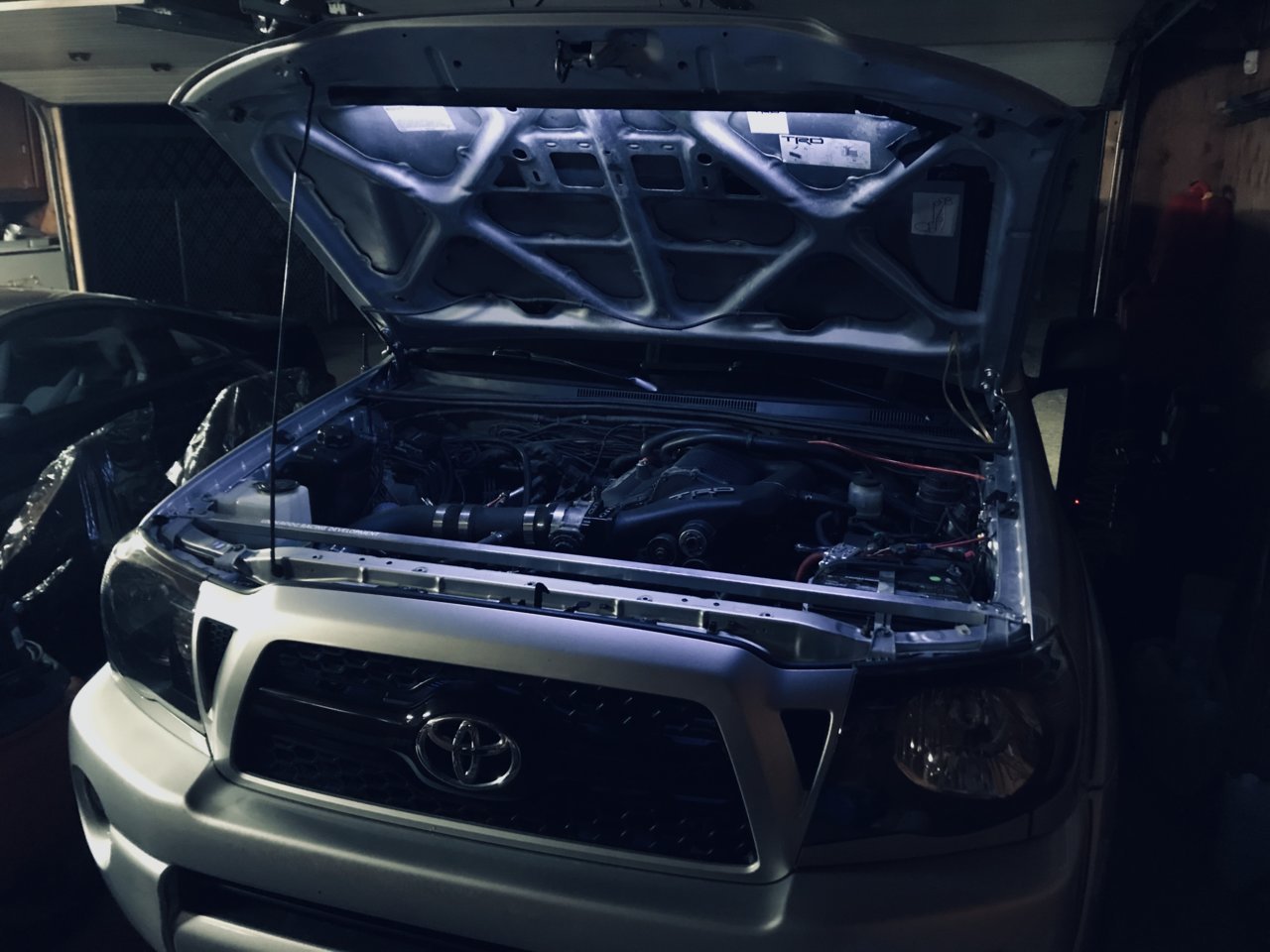

    Mood lighting under the hood!
    TRON, BassAckwards, rmepilot and 8 others like this.

    what’d you go with?
    Athlaos[QUOTED] likes this.

    Waterproof LED strips from Amazon!
