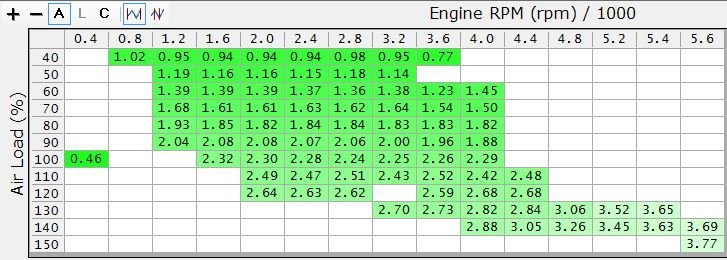

    That's what Kiel said. The same was said about the factory cams vs retarding them but the gears showed more power throughout the rpm range in the datalogs. I've sent a before and after to Justin. Waiting to here what he has to say. Hit 366 g/s of air after install around 5600rpm and before I was usually 350s at that rpm. These maf numbers aren't 100% accurate as my maf tables need some tweaking still but they are close.

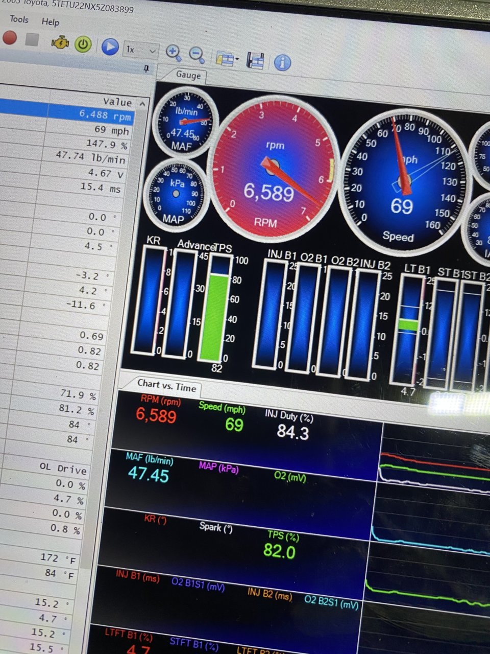

    I’m at 362 g/s. At 6500 Rpms. Think you gotta up that rev limiter lol

    There's a lot to go through here, but on first glance I can see that the torque table will need some tweaking meaning the truck is clearly making a bit more torque. The odd part though is that airflow per revoltuion is down. You guys might not be very familiar with the g/rev unit of measure. It's a unit of measured that is used in some areas in the calibration, but that's not really the point.
    Stock exhaust cam timing
    -3deg exhaust cam timing
    I'm going to have to dig into this further for more analysis. I'll post some follow ups after discussing with Kelby.

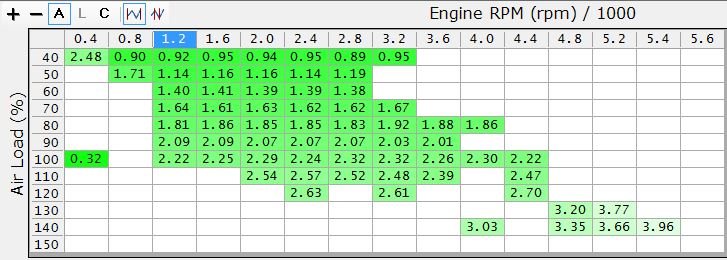

    More still to come. I installed a set of cam gears today on a truck. N/A setup with just an intake and headers.
    You'll see why Kelby's gears are so popular! The truck had noticeable improvement in power pretty much across the board with a good bit more midrange punch. Anyhow. The results shown below are "typical" for cam gears being installed. The interesting thing I noticed with the addition of the gears was the intake resonance was much more pronounced after installing the cam gears. Anyhow.. The point of this post is to show what I typically see with regards to the effects on the g/rev after adding Kelby's retarded gears. Tune remained the same for these runs to keep things consistent.
    Before Cam-gears:
    After Cam-gears:
  20. Sep 13, 2020 at 4:42 PM

    Okay now I’m out of my league. Are you super busy? Would love to learn how to interpret this table. If there is no value listed what does it mean?
