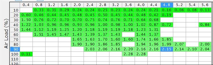

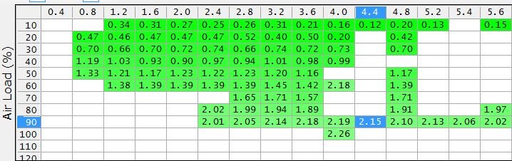

    The graphs above are shown in grams (of airflow) per revolution of the crank. Formula is below:
    [grams/sec measured by the MAF] * 60 / [RPM]

    I'm throwing bits of data up to illustrate my initial observations/first glance at your logs, and what I posted about those observations.
    The addition of the gears in your setup did not yield typical results for what I see when typically tuning a truck with the addition of your gears. The airflow generally improves as seen in my N/A g/rev charts with the retarded cam gears. Your results show slightly less airflow (generally speaking) which is odd in-and-of itself. However your observed butt-dyno contests that. As does the fact you had some torque management stepping in and pulling back a little bit of timing (to reduce engine output) in the logs with your retarded gears which was not present in the log with stock exhaust cam timing. I'm going to have to dig through to see how that came to be.
    In short, I'm really not ready to make any official statements on the addition of the retarded gears with the Kelford cams just yet. Still need to review.. But I want to keep everyone posted on what I'm seeing to keep things open and transparent.

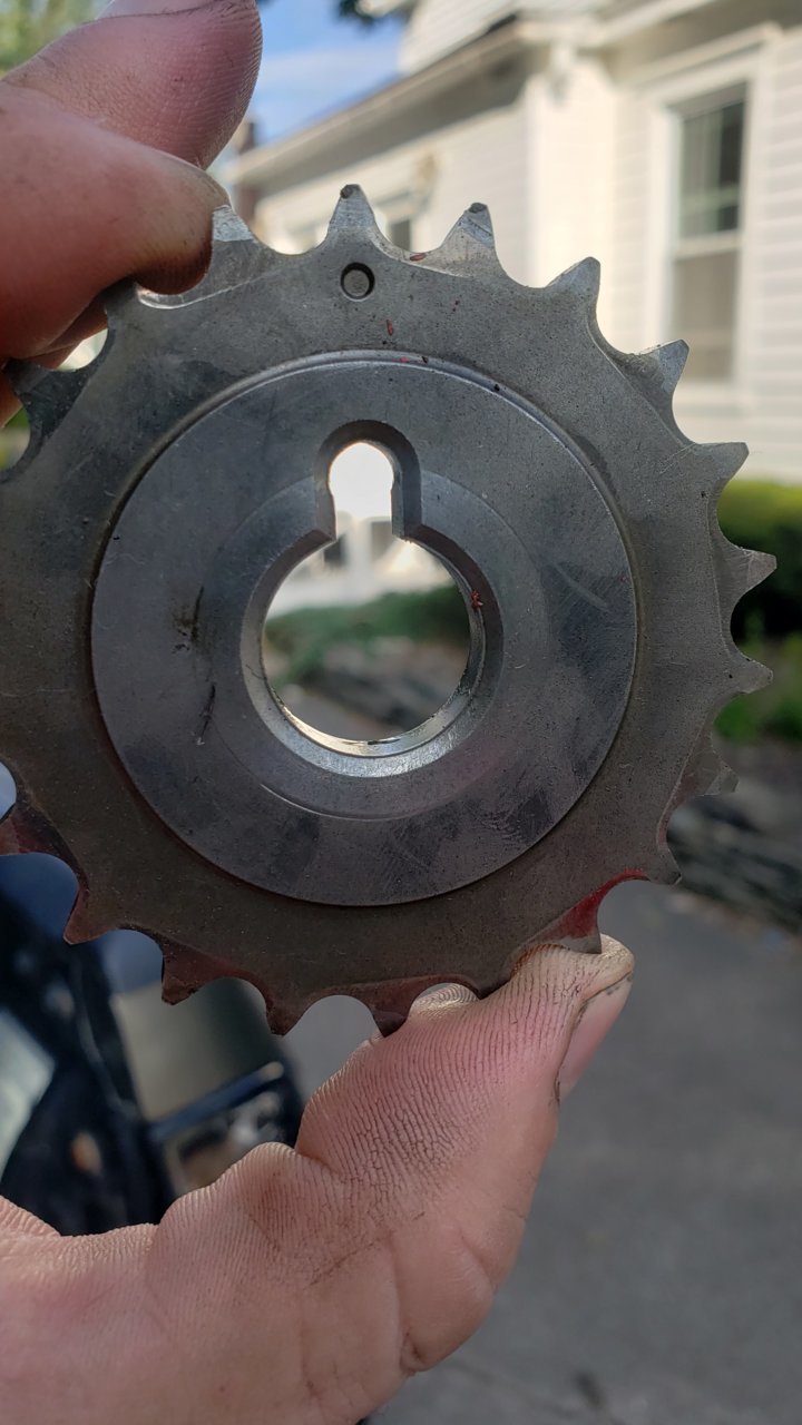

    Another thing that makes me a bit surprised to see this, is just how effing tight the stock fastener is on the end of the cam. Amazing there's any movement at all with the torque applied from the factory!
