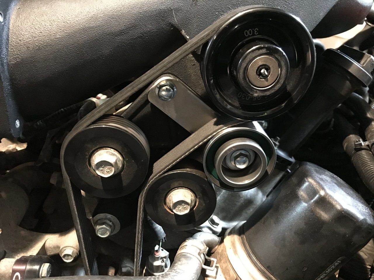

    Where did you get that
  2. Apr 17, 2018 at 5:46 AM
    #3142
    Biscuits
    Biscuits Thorny Crown of Entropy
    Aug 8, 2010
    #41397
    15,577
    Swiggity swangin' biggity bangin'
    From the mad scientist machine shop laboratory of @Roostfactor
  3. Apr 17, 2018 at 5:49 AM

    Thanks!

    I wouldnt say everyone is or isn't. I also think people might be getting some slip and not realize it. It's not like you are building boost and then the belt slips dropping boost to 0. It's more intermittent and progressive than that.
    The problem is we only have a 5 rib belt to grip an already small pulley at 3". This is with the correct belt wrap of 190° as guided by the idler pulleys. This give a total belt to sc pulley contact area of about 5".
    Once you start going smaller with sc Pullies, you not only lose belt contact area from the smaller pulley alone but also due to the position of the non adjustable idler pullies.
    Some info...at a constant 180° of belt wrap, pulley contact area is as follows:
    3.0. pulley 4.71"
    2.85 pulley 4.47"
    2.7. Pulley 4.2"
    2.5 pulley 3.9"
    That is almost an inch less contact area on the 2.5 pulley vs the 3.0 and that is not taking into consideration the extra load (hp) required to drive the sc with the smaller pullies installed or that you get less belt wrap the smaller the pulley.
    What the belt wrap mod does is restore some of lost belt wrap which brings the belt to pulley contact surface area closer to stock.

    I may need one of these..

    Sounds like someone was doing their homework on these pullies!

    The Gates rep was just in my office and yes, the racing blue is now the RPM series.

    Is there a 5-rib belt in the right lengths?
  14. Apr 17, 2018 at 2:01 PM
    #3154
    mr.trd
    mr.trd Are you Recreationally Insane?
    Jul 9, 2008
    #7842
    1,447
    Brant
    Pocatello, Idaho
    '06 S/C 1GR-FE DCSB
    Icon coilovers w 14" 700lb springs, Icon billet UCA w/ Delta joints, custom built Icon rear resi-shocks, Icon stage 3 rear leaf pack, Archive Garage Hammer Hangers w/ homemade spreader bar, superbumps up front and timbren bumps in the rear, Crown brake lines, U-bolt flip,4.88's with front ARB locker and ARB dual compressor mounted behind back seat, 285/75R17 BFG A/T KO2's on Bronze Icon Alloy Compression's, 5th gen T4R budget big brake kit, CBI Off-Road Fab. custom Trailmaster 2.0 with swing-away tire carrier, CBI custom tube front bumper, CBI kickout sliders, CBI full flat belly skids including gas tank,CBI Ditch Light brackets w/ Heretic Studio Quattro's, Heretic Studio's 30" Amber on the front, Heretic Studio 40" bar under the Front Runner Roof Rack, Expedition Essentials RAM mount, Leer used shell, OEM black chrome sport headlights, fog lights always on mod, rear locker anytime mod, TRD supercharger, URD Ucon-EMS, Deatschwerks 255 fuel pump w/ URD external fuel filter kit, AFE intake paired to a Safari Snorkel, URD spec-U exhaust w/ factory Tundra muffler behind URD equal length headers.
    not at the moment. Just a 6 and an 8. But I was successful in cutting a single rib off of the 6 rib.

    Part number?

    And what length?

    Stock belt length is 69.5?currently running 2.7" pulley

    In stock length only, not the 1" shorter belt.
    K050705RPM is the part # for the standard 70.5 belt
    Stock is 70.5, 69.5 is the shorter belt which is exactly like using the stock belt with a 2.5 pulley.

    Are you running the injectors that came with the SC? I'm so rich with the 2.825 that I think the 2.7 should work w/o the 7th injector.

    @Roostfactor Wonder if a larger overdrive pulley helps with belt slip? I hear you with it being intermittent though. I noticed my continental belt slip a little when first installed but stopped after a couple days of repeated WOT :D Like to see a picture up close of these gates rpm belts. A blue SC belt would be pretty cool though
