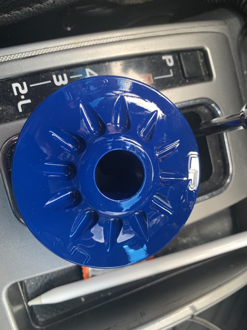

    Got my URD pulley back from a color change prior to install. Can’t have that red! Haha I’m that childish when it comes to sports.

    Looks blue! I can't tell if they masked the mounting surface off or not, but I offer you the following advise:
    - Sand down the the mating surface by hand to make sure its free of overspray.
    - Use a little bit or a lot of antsieze when you go to install it.
    - If you ever think you're going to go to a diffrent pulley, then stop now and get a Smotth Flow setup.
    I had that same pulley as well as a lot of others. Its works great, but when it comes time to remove it, its a real you know what. It does not come off without a serious fight and it will be ruined. Other than that, it looks awesome! Enjoy!

    dont know what sports team but approve the blue, deff sand the inside and might have to heat up the pulley for install on the shaft.

    I don’t think they realize quick chance. I like the blue way better than stock color. Will do mine soon. Did you powder coat?

    Powder coat? Looks sharp
