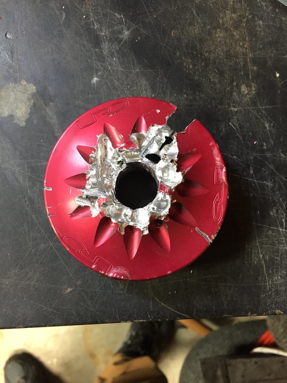

    So u have a screw broken off in the snout of the pulley?
    had this happen and used left handed drill bits to get it out. Had no issues with the thread.

    cutting mine took less than 20 min. in the long game is nothing in time or effort. id gladly offer tips via pm if you opt that route.

    Seriously, though, I thought the same thing when I started out. Then, I decided cutting the snout and installing a quick change hub would posture me for possible future upgrades, WITHOUT having to use a pulley puller again. Very happy I did, since it makes migrating down so much quicker and easier. The moral of my story is do it once in a way that gives you options - cut the snout and install the quick change hub with a 2.8" pulley.

    Go this route. Most of us have already pioneered removing the stock pulley, installing an aftermarket pulley then removing that one for a quick change lol. The second aluminum pulley was a huge son of a bitch to remove.

    Someone repost a picture of that red super-mangled piece of aluminum formerly known as a 2.825 supergrip pulley that someone had fun pulling off. It really should go on page one as a deterrent.

    Why does this pull at my heartstrings so much...

    only two not including the stock one. Had to be cut off both times. :anonymous:

    Second one was butchered. That aluminum just folded under the puller and surgery was involved. I threw it away but now I wish I made a trophy out of it.

    If you can find me the picture I will toss it up on page 1 for the reason you highlighted.
    I'll join the brotherhood. Had a 2.8 stealth pulley that was bad or something, anyway, before installing the blower I had to already perform surgery at the snout, broke a bolt in the snout twice and then had to wind up taking a Dremel to it because it was so mangled and destroyed to high hell.
    Valuable lessons were learned here. Sought for a better option to all the hot garbage that was on the market after pressing in another pulley and eventually wound up finding and making the qwikchange pulley setup a household name in the 2nd gen Tacoma blower community, this thread followed suit shortly after that due to wanting to share knowledge and here we are today. One of the most active threads filled with so many knowledgeable dudes under this thread. :thumbsup:
