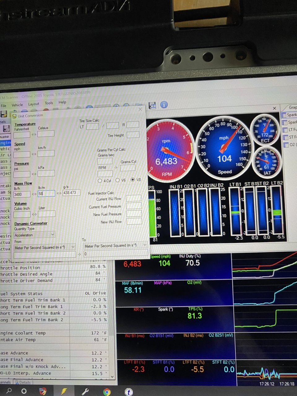

    Also screen shot 438g/s. Pretty 6AADF9D2-3920-4B67-80E9-747B1BD1911A.jpg good id day

    Impressive! What was your maf error at that point if any?

    Don’t think there was a maf error? I dunno what u mean. I’m waiting to hear back from justdsm

    There is usually some. I can't explain it well enough to make sense. Basically if there is a difference in commanded afr and wide band measured afr- than some maf error is the usual suspect.
    Say your truck is commanding 11.5afr but you see 10.5afr. That would indicate at that voltage on your maf sensor it is off some. So in that case you need to drop the number that correlates to that maf voltage node to correct the error.
    In the example above- you would have false high maf numbers.
    That's the best explanation I can give. I'll let Justin take it from there

    439 g/s. My bad haha. Any bets for the morning? Gonna be 36 degrees

    He's using the TRD FJ intake and the factory FJ MAF data with some airflow added on the top end. It's probably a little bit higher than actual, but I can't say exactly how much it's off as I don't have a any wideband data streaming in the log, and we're also working with methanol injection which is messing with how his wideband is interpreting his AFR as it's calibrated for a 14.7:1 stoich value and he's got 'some' mixture of gas, methanol and likely some degree of ethanol as part of the gas mixture. Each with a different stoich value its difficult to determine/calculate exactly what the ACTUAL lambda value of the combustion events are as I have no way of knowing the volume of methanol or ethanol content in relation to the gasoline volume that's being injected.
    In short these values should not be counted as hard numbers, but rather representative as the MAF housing and MAF data are pretty close to stock with most of the "error" being attributed to the inability to accurately account for the actual stoich ratio of the sum of all fuels used. :p

    Dual vvti maf?

    Yes the dual vvti MAF. Lucky for us we have TWO MAF options now. :thumbsup:

    I was curious about the IDC, then saw the ~70%. Which size injectors are these?

    FIC 650cc/min

    Good deal. What was that relative MAF to brake HP multiplier again? 1.12?

    I'm not a huge supporter of of the MAF g/sec multiplier for HP, I did a little "testing" of those multipliers when I dyno'd my Mustang. It was 'ballpark' accurate..
