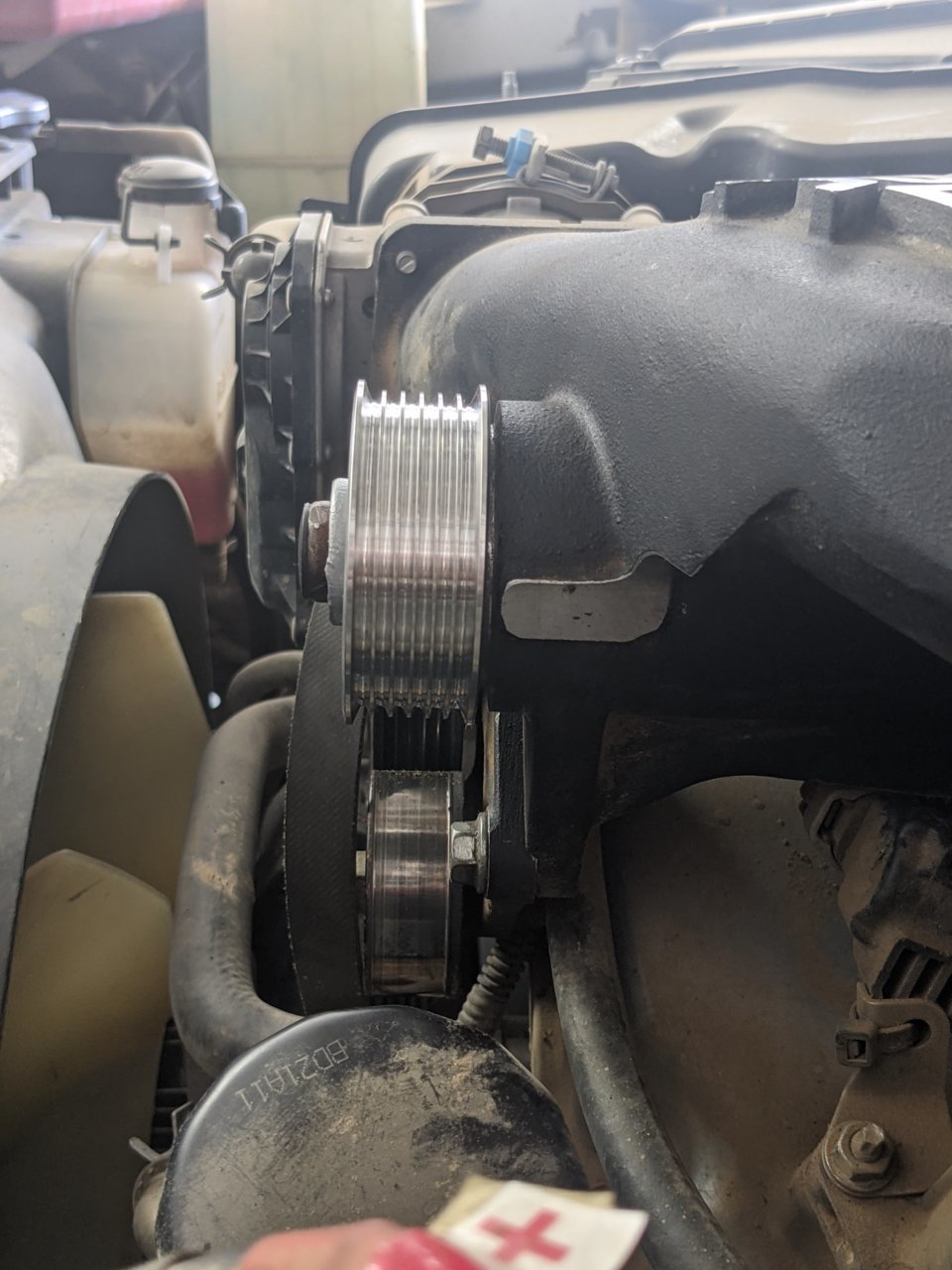

    How much of a difference is the double roller going too make? running no cut belt would be ideal.
    @12TRDTacoma what belt did you run with the 2.8 recently

    The double roller adds more stability and better track width to the setup to prevent the belt from potentially coming off or being off track.
    OE size 70.5 RPM. I am currently running a 2.7. I should probably get retuned but I like where things are currently.

    Nice still running Rousch and double? I still have the OE belt never used should I give that a shot or cut the other belt I have?

    Still running the Roush and double. Get an RPM. They rock.

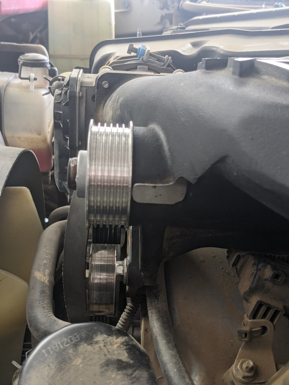

    You’re running the pulleyboys hub and going with a smoothflow pulley now, yes?

    I’m using the Rousch tensioner. But, with the pulley that came with the blower.

    For a 2.8 I’d run the Rousch tensioner with the “normal” pulley that came with the blower and the RPM belt. Shouldn’t need any extra wrap fanciness for that size.

    Hmm now you got me wanting to check this out. I have pulleyboys hub and 2.5 with smoothflow 2.3 on the workbench.

    Can you not bump the hub further out with a puller?

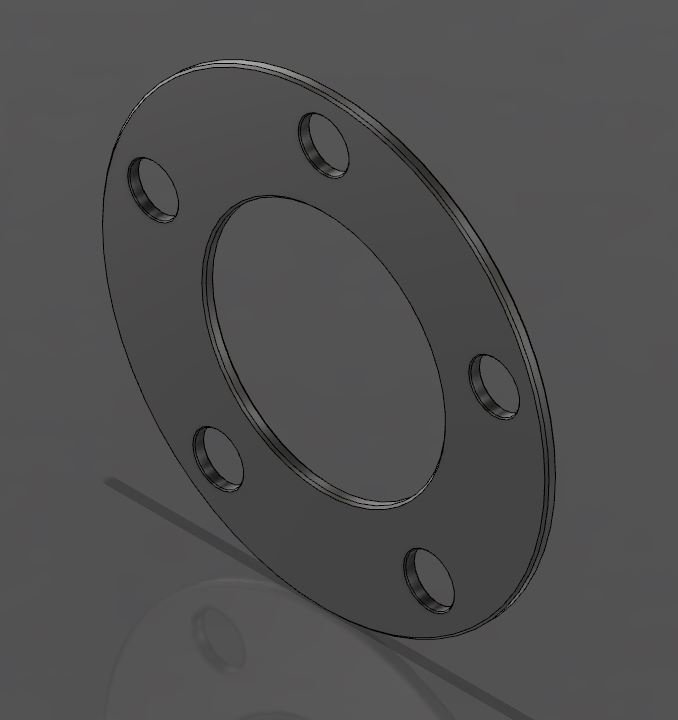

    Sounds like you may wanna punch out a few of those spacers there @XPOTRPR

    Correct.
    I could, but a spacer would allow me to revert back easily and not mess with belt alignment again.
    Probably will. Such an easy part.. could knock out a few real quick on the dual spindle lathe with live tooling. Whole thing done in one machine.
