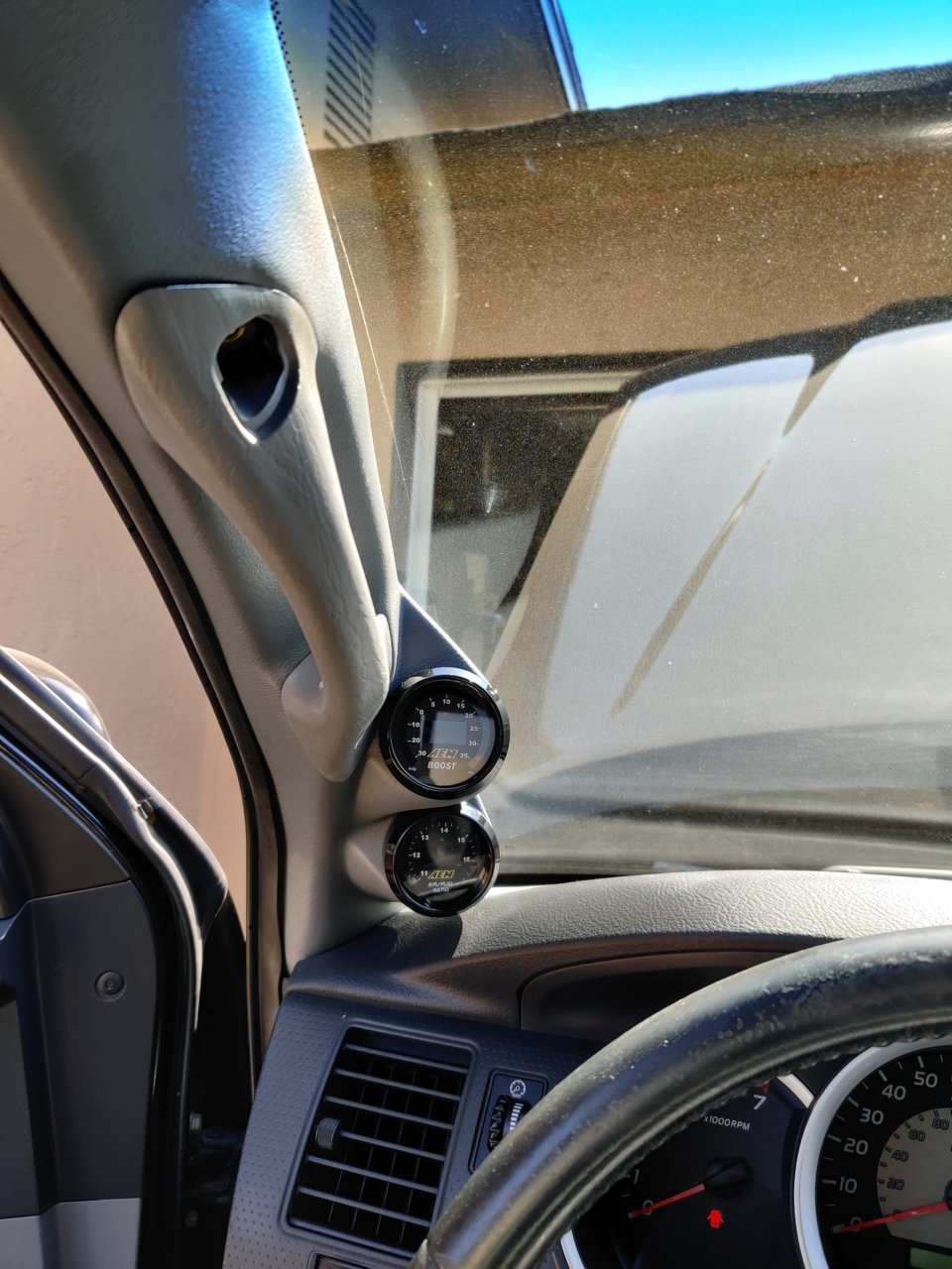

    i had to trim the handle for it to fit better.

    I trimmed the pillar pod not the handle so the mod would be fully reversible without having to buy a new handle if need be.

    that was my faux pas. 34$ for a new handle. now i have more exter parts....

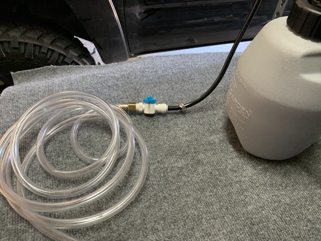

    i used the maxlife. Happy with it. Do yourself a favor and make a larger pump before you do it

    Thats a big step up from the bottle pump I was planning to use!

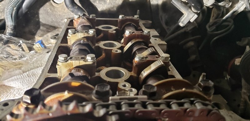

    New headgaskets, timing chains in, need to do oil pump rotors and seal her up. Also finished cutting the stanchions on the wrap mod. If anyone needs one, maybe I can ask the shop to do a few at a time. Best to wait for my testfit to proceed on fitdament
    20200926_210758-01-02.jpg Screenshot_20200929-052153_Messenger Lite.jpg 453b3bbfa2426bc15af3688728d5d281.0-01.jpg

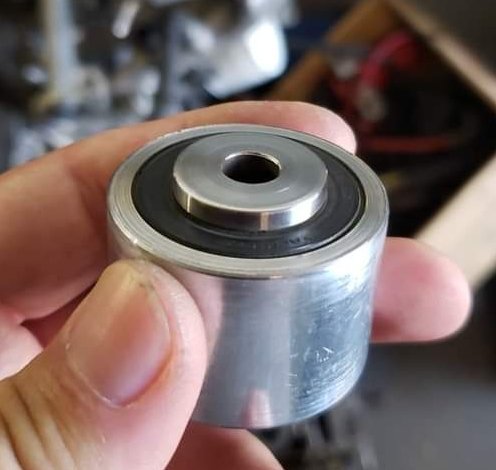

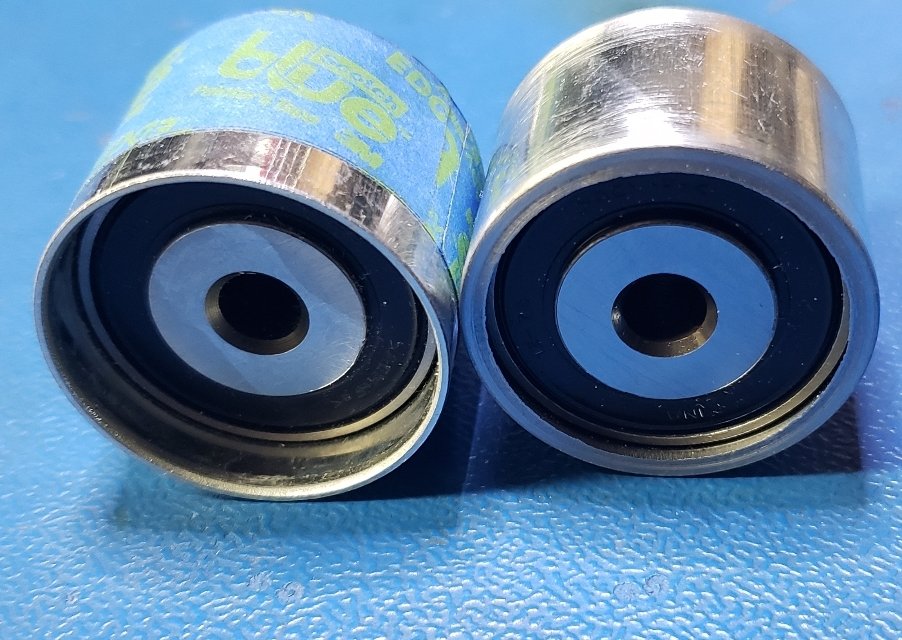

    makes the process a whole lot faster and easier. Cowt me less than $20 to make.
