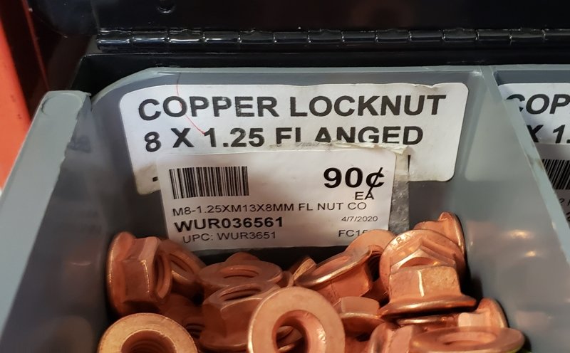

    Wurth 036561 Copper plated hex flange nut 8x1.25 self locking. Couldn't find these in the normal aisles at my industrial hardware. They had a separate bin for Wurth stuff. All the other high grade flange nuts I could find were serrated flange.

    sweet path of good hardware!
