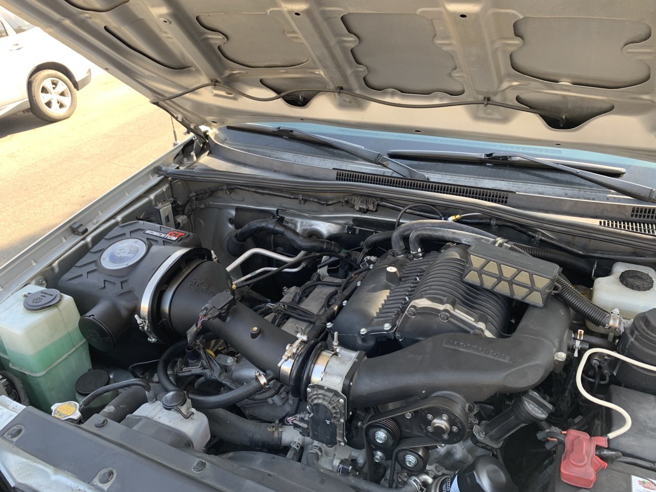

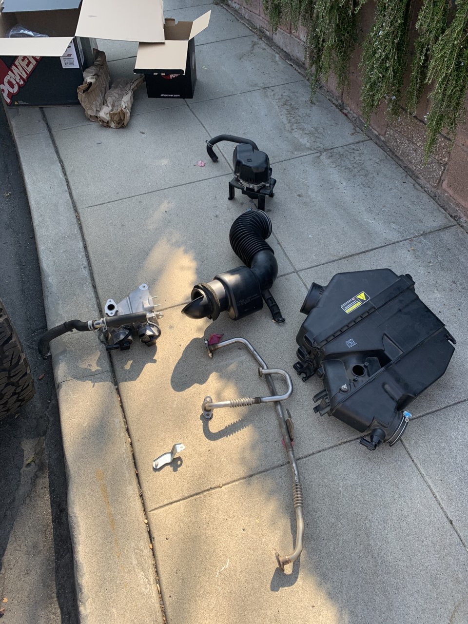

    So this happened over the weekend. Thanks @Roostfactor and @JustDSM.
    So initial thought on the AFE Momentum GT. Fully respect the engineering and design time and costs, but the material could be better for the price point. I went with the pro-dry filter, and it is a beast, but the plastic used on the housing feels on the cheap side. Slightly louder than the stock intake, but not significant. Also, for the price point I should not be pulling fasteners off the stock setup to reuse in the new intake - petty stuff, but yeah.
    Hopefully next weekend I will get a chance to do some logged pulls for comparison against stock.

    im actually a little jealous. I want to do the SAI delete but don’t have the ability to reflash my truck back to the 05-11.
  14. Oct 5, 2020 at 7:46 AM
    BassAckwards
    BassAckwards Well-Known Member
    May 3, 2016
    #186002
    27,906
    2009 Tacoma AWD Turbo 2TR-FE
    Full-time AWD & BorgWarner EFR 6258
    JustDSM should be able to help you. I have it deleted on my 13
