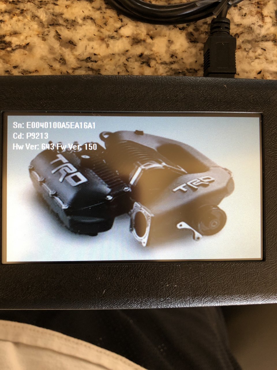

    2013 DCLB
  15. Apr 18, 2018 at 2:27 PM
    #3215
    snowsk8air2
    snowsk8air2 how hard can it be?
    Sep 16, 2011
    #63607
    10,571
    Flagstaff, AZ
    Supercharged TX Pro
    2011 S/C and basic mods
    Is that one mine?
    jojotoo and GT7[QUOTED] like this.
  16. Apr 18, 2018 at 2:28 PM
    #3216
    GT7
    GT7 One piece at a time
    Aug 15, 2014
    #136201
    2,502
    Grant
    Phoenix
    2013 DCLB
    I wish I had that kinda money!
