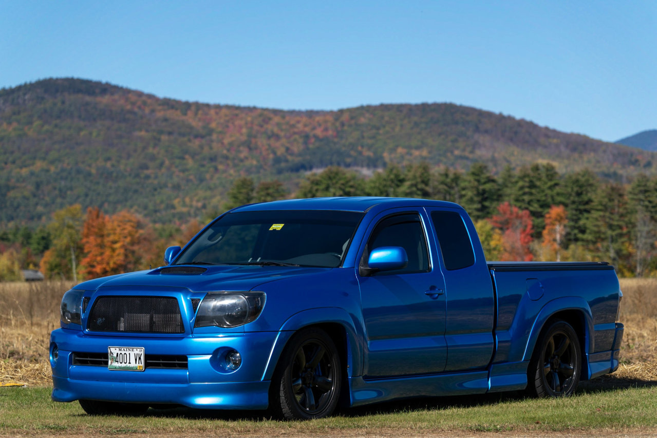

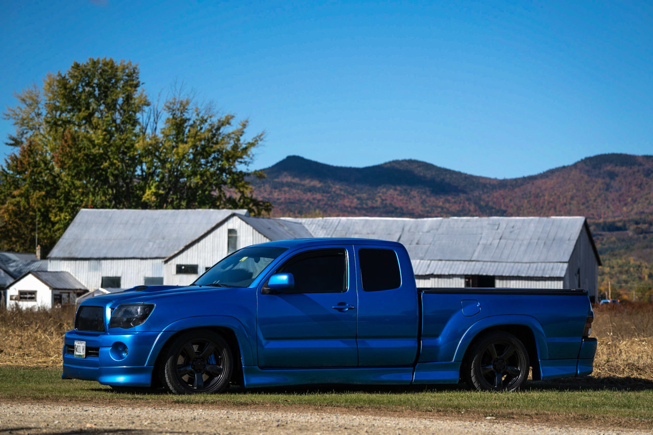

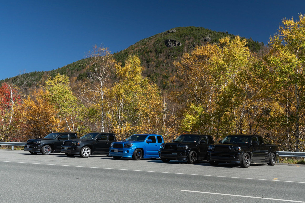

    Man that back drop. I’ve lived so far south for so many years I haven’t been able to see the color change of fall in a long time. Made me homesick

    SWB stealing the show!

    That’s looking sharp! How do you like the engine so far?

    Just add this to the list of reasons why I need to get back north....
