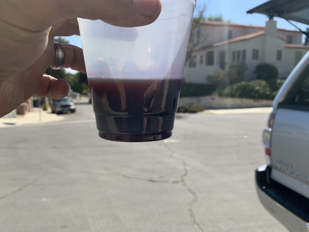

  16. Oct 12, 2020 at 5:32 PM
    aboftofbeam
    aboftofbeam Well-Known Member
    Feb 11, 2018
    #244128
    121
    Karl
    San Diego, CA
    2012 Taco Off Road DBCB
    S/C, UCON, 2.8 pulley, bedrug, Crashnburn's ultimate headlight/tailight upgrade, Moroso oil-catch can, soundproofing, speaker and H/U replacements, bed stiffeners, SHMELLFAB Sliders, ICON AAL.
    So I am in a 2012 with only 51k miles. I had changed the gear oil in my rear diff and transfer case at 40k, but never got around to the front diff. The rear was as expected - gross. The transfer case looked like new - so I assumed my front diff would look good.
    I was wrong. Very dark with about a 1/4 inch of gunk on the magnet and tiny particulate throughout the oil. Seemed pretty thin too, almost watery. Best guess is that because I do very little in 4x4 I am probably not heating it up often enough to drive condensation out of the gear oil. This is exactly the same reason I told my self it was going to be fine - I do very little in 4x4.... Resetting my diff fluid changes to every 25k.
    Next up was the Transmission Flush using @mountain lion's writeup (https://www.tacomaworld.com/threads/diy-full-flush-for-automatic-transmission.68462/ )
    Tranny fluid looked better than my diffs, but not great for 51k miles. Pretty dark in the brown/pink spectrum. No burned smell though, so at least there is that. Pretty easy, but I did feel like I took a bath in tranny fluid when the hose from my pump popped off and soaked me down :anonymous:.
    Keep your fluids fresh gentlemen. Now back to superchargers and all things that blow :bananadance:.
