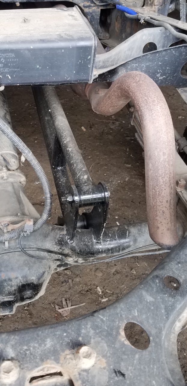

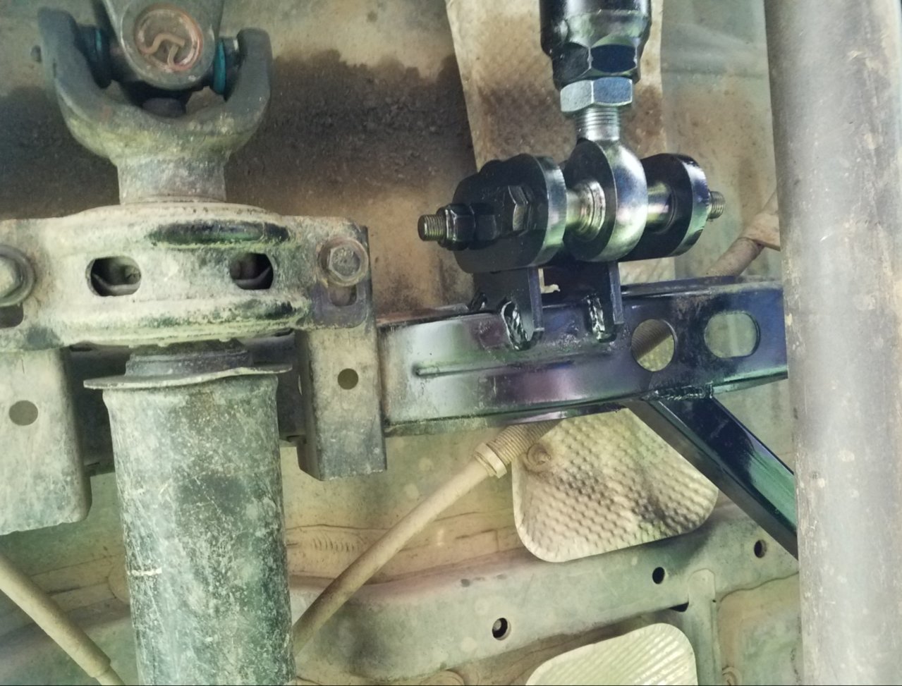

    I noticed other day- the traction bar I built has managed to rip the frame cross member in half. I used the cross member the carrier bearing uses. I had gusseted and reinforced the cross member but now I'll cut the whole piece out and go full overhaul.

    Got any pictures before the carnage? I remember there being a thread about traction bars. Got some real debaters in there. Anyway, the hinged method that Calvert Racing uses, is very effective, while preventing unwanted binding. Curious if this is something yours has? Also curious of your new design thoughts.

    Did you have to build new backing plates for the u-bolts to attach to since your truck is lowered? Curious how this would work with the caltracs

    I used a perch to make mine spring under axle. The Caltrac kit comes with an Xrunner backing plate, with welded on tabs for the trac-bar.
    They also make kits for lifted trucks.

    I'll cut the entire c channel cross member out and have 2" square tube in its place.

    How does yours look at the axle connection?

    Welded in place. I might reinforce it even moreScreenshot_20201015-153038_Gallery.jpg

    I have an idea, if you are interested?
