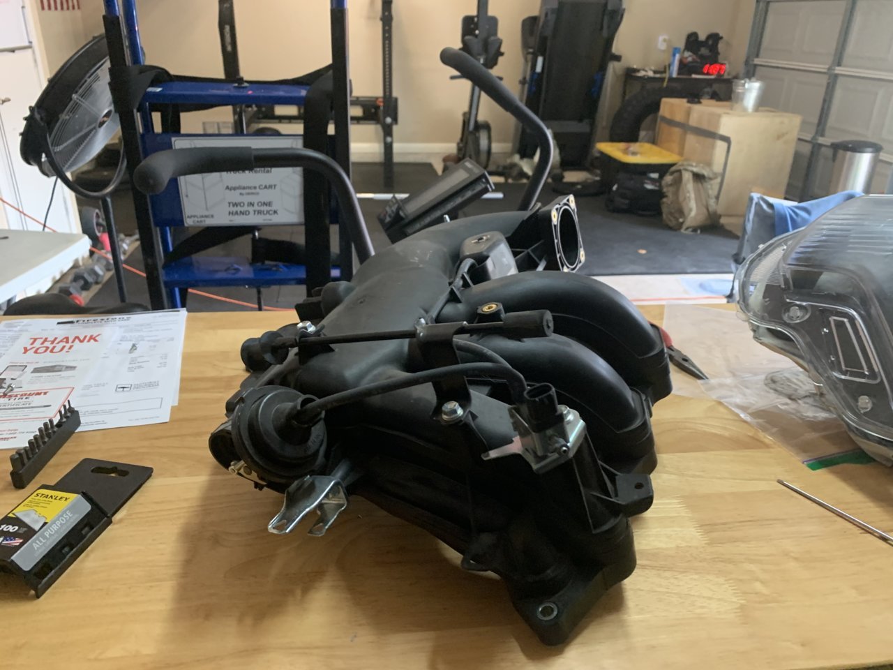

  2. Oct 20, 2020 at 12:11 PM
    MightyMouseTom
    MightyMouseTom Balance off road vs on road performance
    Jul 11, 2019
    #298971
    1,119
    Tom
    San Antonio, Texas
    2013 Black DCSB
    2inch lift, 285/75/17 Nitto Trails Grapplers, Billy 6112/5100s AAL, Alpine Design Cab mount relocation, TRD Supercharger w/URD pulley, Volant Ram Air Intake, TRD Exhaust, Katzkin, TechDeck, Ram mounts, Audio w/hideaway kicker amp, CBI skid, Custom grille, and SS3 fogs

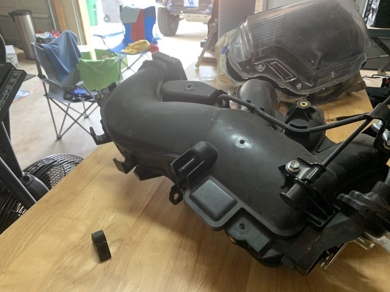

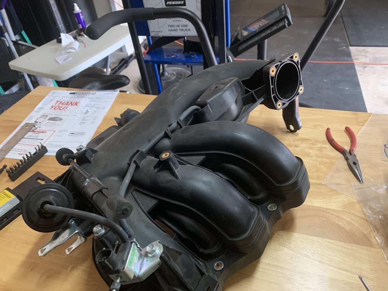

    Only photos I have on the phone though. Doesn’t show the condition of the actuator.

    Can someone enlighten me as to wether or not the actuator comes off? Would suck to ship the whole thing if he only needs that little part

    I can check when I get to the house. Just not home at the moment.

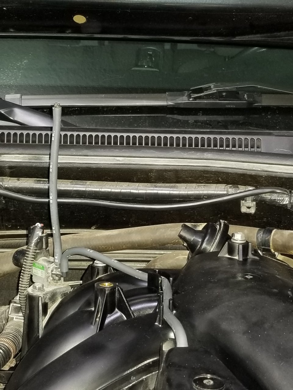

    Thanks to all of you guys who checked on this for me. My JB weld is holding up for now, but I am still interested in an assembly as this is only a temp. fix. I'm also looking into getting one of those spacer guys when they decide to do another GB, I can swap all of those at the same time.

    I have to retract part of my last statement, I popped my hood a minute ago and noticed this...
    I guess the JB weld didn't hold as planned. Truck drove perfect, and I got no lights...:notsure:

    No CEL will occur. It’s just the actuator for the ACIS flapper valve.
    With the valve in-op you’ll not get the long runners activated to help low-end and midrange.

    I used some epoxy that we use on aircraft and it didn't hold. It's such a small
    So is it safe to drive until I get a good epoxy hold on it or a new upper intake manifold? Not my only driver.

    100% safe.
