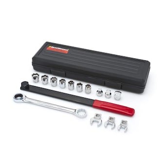

    Yeah, that would be the supercharger belt tensioner. Two 14mm nuts, one top and one bottom, and one 12mm bolt on the drivers side should remove that(after you take the tension off the super charger belt) then you have unabated access to the serpentine belt. Just take the tension off that, slide it off. Route new belt and replace supercharger tensioner, preferably with new belt there too. I like the gear wrench serpentine belt tool, it’s my favorite.

    I'm gonna try that first thing in the morning I need a new belt asap so it should work just that easy huh LOL Mahalo my dude trucks been down for almost a week and haven't had any time for it

    I got a better one for you boys which is actually really ideal for our setup if you are still using the fan clutch setup, especially if it's a tighter fit in there still. The Gates 91011 tensioner tool set. Comes with 3 different rachets one 1/4" rachet, one 3/8" rachet and one 1/2" rachet. All slim profile, all highly effective.
    Just save a set for me boys. :) :thumbsup:

    I like that you can angle the end wrench portion from the lever arm. It allows you to sneak it in to all kinds of places. I’m surprised at just how frequently I use it.
