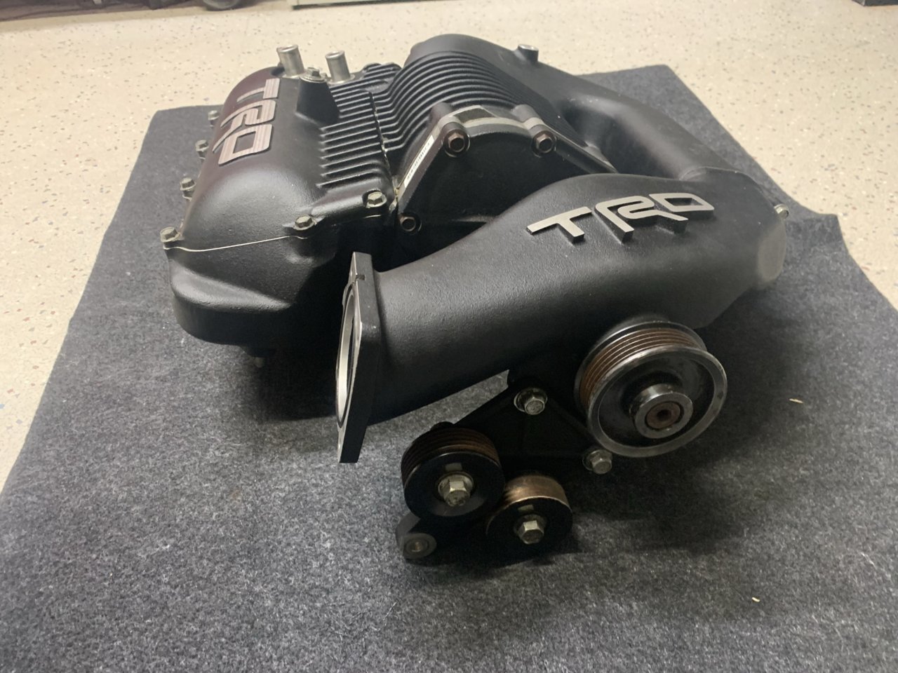

    Can anyone point me in the right direction on a few questions? I was told this was fully rebuilt (but no receipts). No other hardware for installation. my questions are:
    1. What is this worth?
    2. Where could one go about getting the hardware to installing?
    Athlaos likes this.

    1. Not sure what it's worth. I can tell you I'd probably pay $4000 for it, since that's about what a rebuild of my own unit would cost me.
    2. I'm not sure you can get the fit kits any more. I could send you a PDF of the contents of a fit kit though, and you could potentially piece everything together yourself.
    Edit, I'd also ask if he did any upgrades like a ceramic coating on rotors or porting.

    Further to that, without receipts, I'd either want to take it apart to check the condition, or have him ask the vendor for another copy of the receipts. That should totally be possible if he did get it rebuilt.
