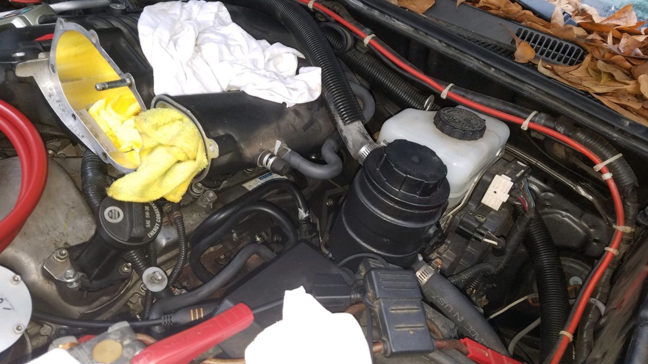

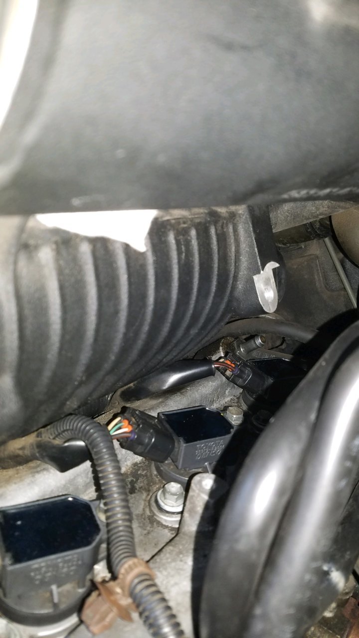

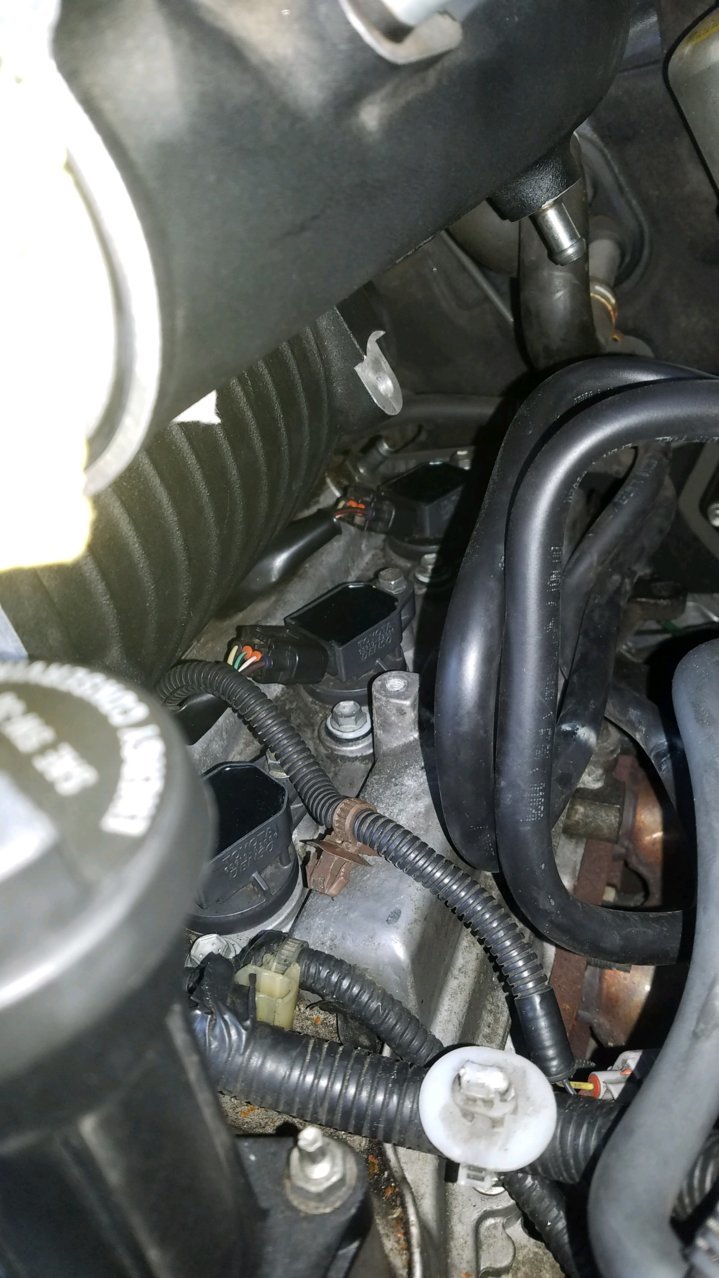

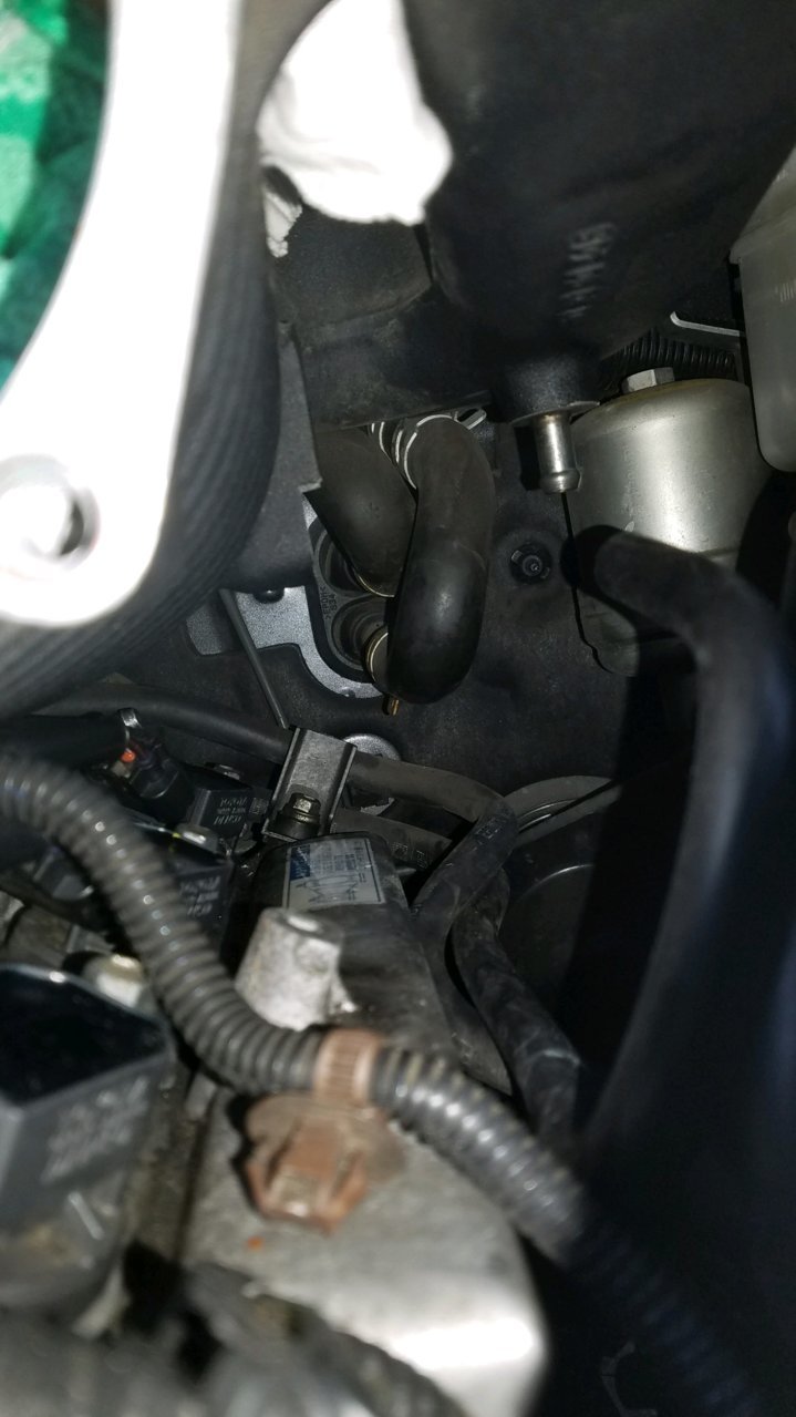

    Just for the plugs, I removed everything that was attached to valve cover. Let me go outside and take a pic.
    JuanitoBonito likes this.
  17. Nov 29, 2020 at 11:27 AM
    BenMara
    BenMara That Asian RedNeck
    Apr 14, 2011
    #54903
    1,944
    Ben
    Belton, SC
    2011 DC 4x4 SCed
    TRD Blower, Ham Radio, DBA T2 Rotors
    Dont know how clear you can see everything i removed. 20201129_141850.jpg 20201129_141900.jpg 20201129_141912.jpg 20201129_141926.jpg 20201129_141933.jpg
