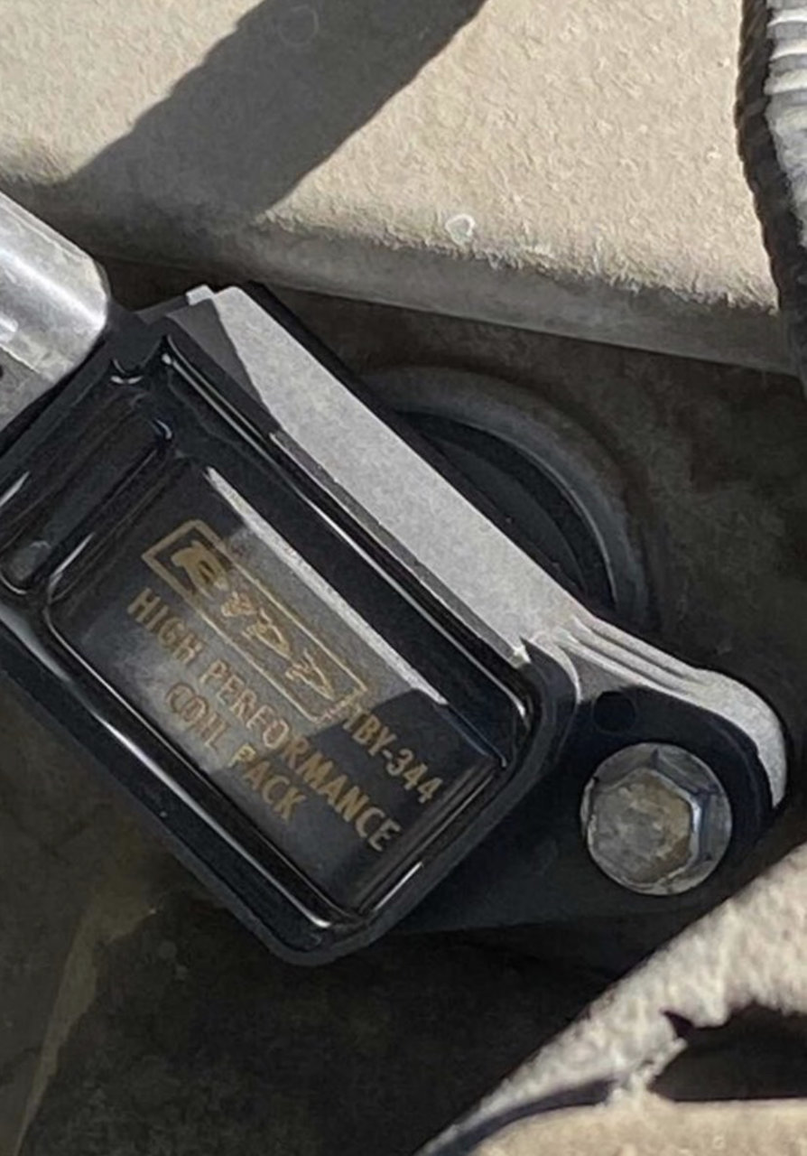

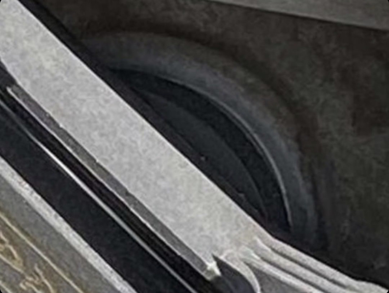

    RIPP tested their prototype not a new one says it fits but at least in the photo it’s still rubbing the valve cover. Even then it still looks like it’s not fully on as he noted.

    @SUMOTNK @alvinfromhawaii and whoever else may have ordered. Let me know if you guys can try fitment on the passenger side and see how it goes. Seems like this is going to be a he said she said but the fitment is so damn close that I'm surprised they did not take that into account so there was some room for adjustment.
