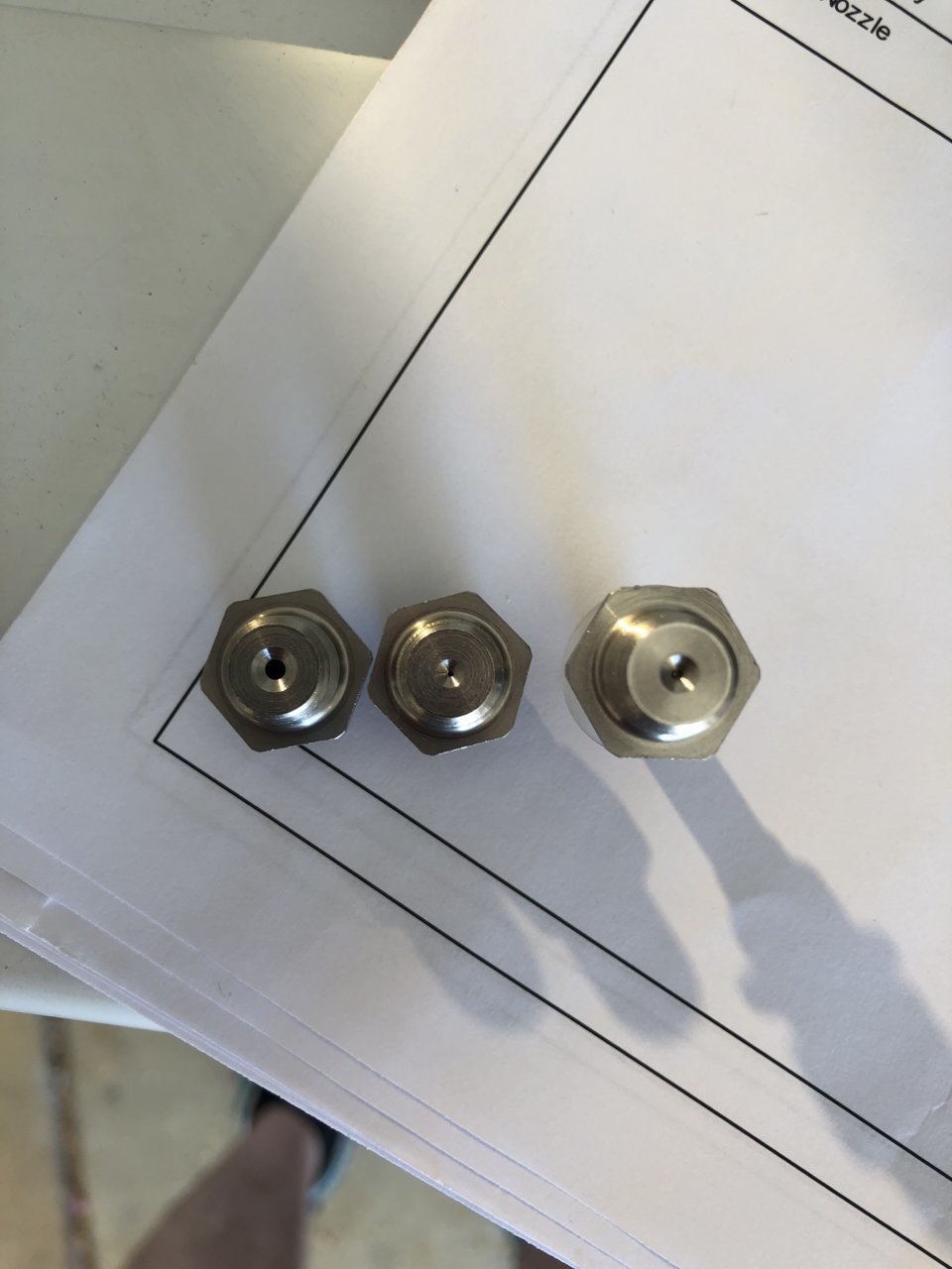

    Snow performance offers braided lines. I just went nylon and covered it in loom for extra protection. They have me enough line to do it twice so I've got back up too.

    Every guide I looked up said that map A was timing retard and map B was fuel

    Sounds like since both camps are at odds, time to go back and make sure which maps are fuel and timing. Doesn't hurt to double check. Let us know what you find.
    Also, post a picture of your map A please.

    Start small then go up as required.
    1000cc! Damn!

    Its cheap! Idgaf. 30/70 mix is what ill be using
